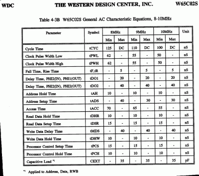

All WDC datasheets that I've seen say, W65c02S is a 14 MHz device. I would never known about the 10 MHz version, but I had bought it. I believe that AC characteristics should also be different, but how to get them? Does anyone have this information?

Are you looking for the timing specifications for an older 10MHz version? I don't have those; but the current (14MHz+) data sheets are on the manufacturer's website, at http://westerndesigncenter.com/wdc/documentation.cfm .

What do you mean by saying 'On my older one...' ?
I found it. I was forgetting I had a 1992 data sheet on paper. I'm attaching the timings page.

Thank you Garth, this is just what I need... :D
