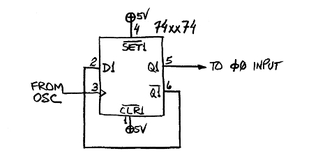

TM9918A specifies 10.738635 MHz (+-0.005%) crystal, with distortions known to occure when using 10MHz. In my local shop I was able to get 10.7MHz and on ebay 21.47727MHz (double the required value). So do you know where to get the crystal online or tell me/link me how to divide the double one?
I recommend you use a can oscillator for this purpose. If all that is available is the 21.47727 MHz version you can run its output through a flip-flop to generate the required 10.738635 MHz signal.
File comment: Clock Generation w/Flip-Flop
The above circuit is from Garth Wilson's site and shows how to do it. The clock output is gotten at the flop's Q pin. The recommended flop is a 74AC74, which is available in DIP and SOIC packages.

PostPosted: Thu Sep 15, 2016 6:42 pm
Posts: 8540
pogof wrote:
@BigDumbDinosaur I dont quite understand how that should work. When I use, say NE555 I know that it generates square wave on one pin. So that mean that I use two of the flipflops, one for each leg of the crystal? Specially these two leg metal can crystals are black magic for me.
BDD was recommending that you use a can oscillator, not just a crystal. The crystal by itself is a passive device and will not oscillate. It is a resonant circuit with an extremely high Q. It has to be put in a circuit with one or more active components if you want an oscillator. If you get an oscillator can instead of just a crystal by itself, the details of making an oscillator that is stable under the range of temperature and other conditions have already been taken care of for you, and the price is hardly more than just the crystal. You might also save board space because the entire oscillator, including the crystal is inside the can. These oscillator cans typically plug into an 8-pin DIP socket, or a 14-pin DIP socket. (These are the two common non-SMT sizes.) There's a picture of one at about the middle of the page at http://wilsonminesco.com/6502primer/ClkGen.html .
The oscillator can has one output pin. If the 21.47727MHz (double the required value) one is all you can get, what BDD is recommending is that you get that one and put it through the FF circuit to divide the frequency by two. You only need one FF section, for example half of a 74AC74. The oscillator has four pins, but only one is output. Run that into the ck input of the FF. the FF's Q\ ("Q-not") output goes to the D input, and you take your desired output from the Q pin. The duty cycle will be 50%, even if the oscillator's duty cycle is not.
