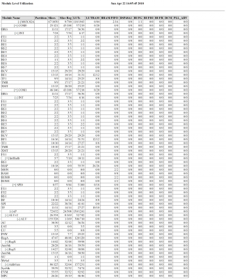

Thank you for your compliments.
Per your request, a screen capture of the Module Level Utilization Report is included below. That is followed by the PAR report for the M65C02A targeting a Spartan 6.
The core is undergoing some changes, and at the moment, I can't vouch for its correctness. The project synthesized includes: 28kB Block RAM memory, 4kB Block RAM microcode memory, Vectored Interrupt Controller, User/Kernel Paged Memory Management Unit, Buffered SPI Master, two Buffered 16C550+ UARTs, and a placeholder External Memory Interface. Thus, the core is complete, but not yet fully tested. Some questions remain regarding whether the approach taken to implement the base-relative and stack-relative addressing modes using the native indexed by X addressing modes will suffice. A prior implementation allocated a significant number of opcodes to these addressing modes at the expense of the Rockwell instructions and general compatibility with the W65C02S. As currently implemented, the M65C02A implements the instruction set of the 65C02, and leaves out the WAI and STP instructions from the W65C02S. Those two instructions are replaced by two instructions, OSZ (Override X with S, plus Set operation/operand size) and OIS (Override X with S, plus Set operation/operand size, plus Add indirection to addressing mode). The microcode for the WAI/STP is included in the microprogram, and all that is required to put the instruction set of the M65C02A into compatibility with the W65C02S is a simple update of the microprogram files.
I am currently creating a model of the core in Python 3 for use with Mike Naberenzy's Py65 toolset. Since Python is not my native language, it's taking a bit of effort on my part, and it's not going to be particularly Pythonic. Once thing is clear, though, and that is that a significant amount of effort will be required for testing.
