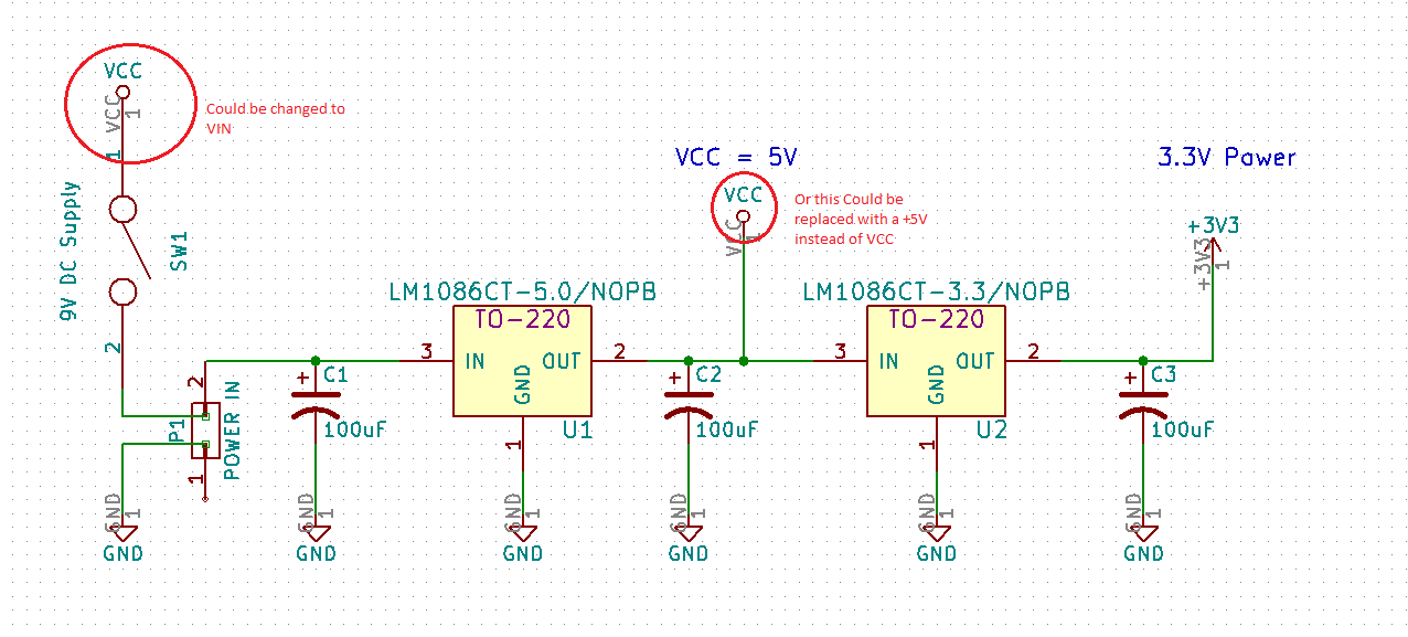

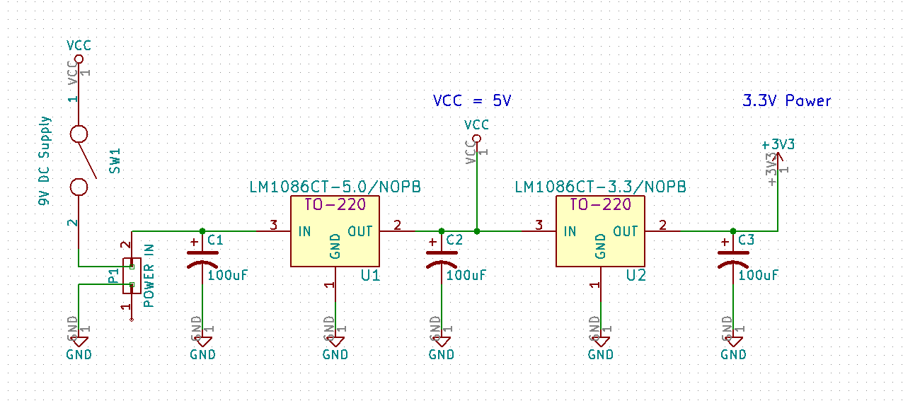

Updated. I left the caps at 100uF. Mainly because it seemed like it should be OK and the fact I have many of them in stock.

There's a serious mistake in your schematic: you drew a switch and a (possibly external) power supply on the left side, but the schematic program is going to interpret this as part of the project. And you connected what you intended as the positive side of the power supply, to VCC. So instead of the switch interrupting the current between the Power In socket and the 5V regulator (which is what you want to do), you now have it shorting the "power in" socket to the 5V rail!
If you design a circuit board from that innocent-looking schematic, be prepared to see some magic smoke when you close the switch :-)
===Jac

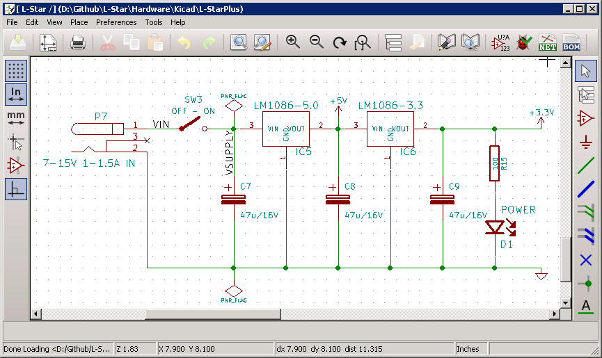

This is the power supply in the head revision of my L-Star project. If you want the Kicad version, go to https://github.com/JacGoudsmit/L-Star.
It's essentially the same as your schematic...

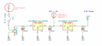

Your Power input and 5V rail need to use separate power components on the schematic or your PCB design software will consider them to be on the same net.
See below for more info
