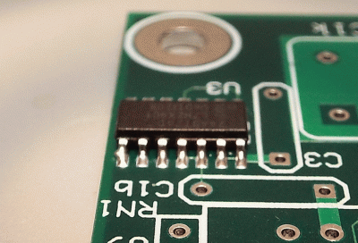

File comment: Flip-Flop Close-Up
Above is a close-up of the flip-flop. These SOIC14 packages sure don't take up much room. :D For some reason, my camera kept trying to focus on the silk screening in the foreground, making the subject (the flop) a bit blurry.

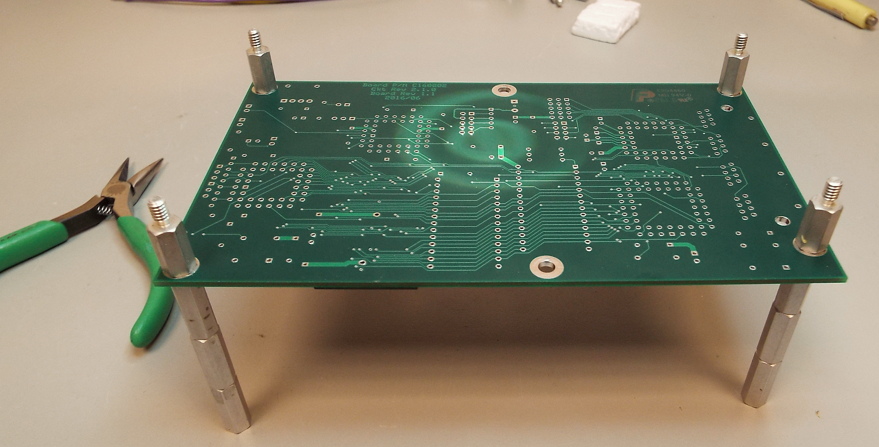

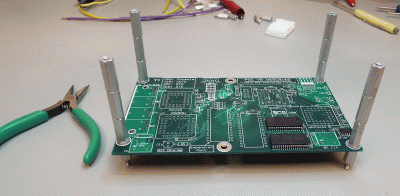

File comment: PCB Ready for Assembly #1
File comment: PCB Ready for Assembly #2
Above is how I set up PCBs for assembly. It's nothing fancy—I've been using this crude method for some 40 years. I put rubber caps on the long ends of the standoffs so the assembly doesn't slide around on the bench whilst poking it with the soldering iron. The caps are 8mm vacuum caps commonly used on automobile engines.
I'm embarrassed to admit I'd never have thought of doing that. That would have been a very handy approach when I was soldering up my MAXI09 board (25cm x 20cm or so). Oh well, I'll do that next time.
