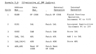

On the other hand, the MOS MCS6500 Microcomputer Family Programming Manual (January 1976) contains a cycle description (page 141) that shows the wrap around as documented:

Arlet wrote:
the MOS MCS6500 Microcomputer Family Programming Manual (January 1976) [...] shows the wrap around as documented:
And yet, section 9.8.1 (page 141) of the same manual documents the opposite.
    "In the JMP Indirect instruction, the second and third bytes of the instruction represent the indirect low and high bytes respectively of the memory location containing ADL. Once ADL is fetched, the program counter is incremented with the next location containing ADH."

Yes, many datasheets are either wrong or inconsistent - and therefore wrong! I'd take the table that Arlet notes as an extremely subtle admission of the bug! It seems pretty unwise to try to document internal operations in such a detailed fashion. Even if everything is correct, it makes it harder to make subsequent improvements. Having undocumented behaviour can be a feature.
I think everyone here who's spoken up, with the exception of litwr himself, regards that wrap-around as a bug. (But I'm not sure if it's even interesting to keep arguing about what we call something. Much more interesting to talk about how things work and how to program them.)
