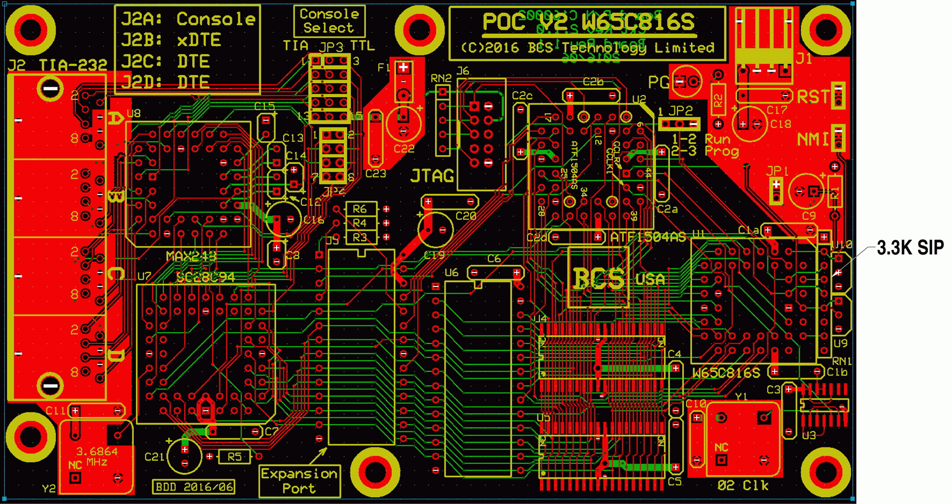

I'm laying out my board (PCB) and I'm putting the pads in for pull-up resistors.
It's going to be a tight squeeze to get each one next to the 65C02 pins.
So my question is, how close should pull-up/down resistors be to their respective pins?
Obviously, as close as possible but if I have a small area...say 2-3 inches away...that could hold a group of resistors nicely, would that be an issue?
Max speed of this board would be in the 1-4 MHz range.

At the speeds you're are contemplating distance shouldn't be critical.
I used a SIP for the pull-up resistors, rather than individual resistors, since most of them are connected to MPU pins. I was able to tuck the SIP in real close to the MPU's socket.

Since the resistance is going to be far more than the inductive reactance at the highest speeds of interest (say, ~50MHz for the needed harmonics to get a squarish wave at 4MHz), the length of those connections won't have any significant impact. If they were super long, reflections could become a factor, but that's not going to happen with the maximum lengths you're likely to have on a reasonable-sized board. I wouldn't worry about it.

How did the SIP work? Was it tricky routing all of the input pins to the SIP since it was so close to the MPU?
Thanks

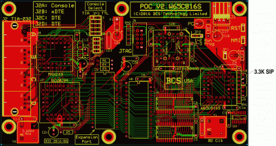

Routing was no problem. As one picture is worth lots of words, here's a pic of POC V2's PCB, with the SIP resistor array pointed out (right side).
File comment: POC V2 SIP Resistor Positioning
The particular array I used is a Bourns 4609X-101-332LF, which is eight 3.3K resistors. See attached data sheet
