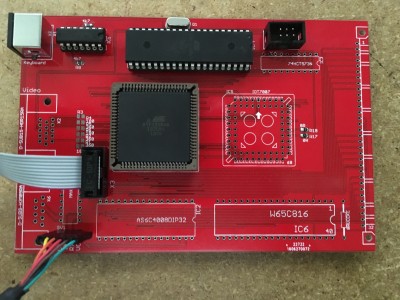

So I finally decided to go the PCB path. After the concepts have been tested with ROMulus the 1st on some breadboards I wanted to build something more durable. ROMulus the 2nd has all the features of the 1st but also has some enhancements. When finished it will (should be) able to emulate an Apple IIe including the double hires mode with 160 x 192 pixels and 16 colors. However due to the design you can convert the system into whatever you want. Everything is "configurable" within limits, that is as long as the CPLD design can be implemented in the CPLD and the given allocation of the PINs fits the design you're save. And as with all the ROMulus there is no ROM, there is only some RAM that emulates ROM, all depends on the CPLD design. It basically features
- A home-brew video controller using a ATmega1284P with 32kbyte dual-port video RAM and VGA output (560x480 pixels, this is due to the fact that I want to use the 7-bit wide original character sets of legacy systems)
- A PS/2 keyboard interface using the ATmega1284P using one of it's USART in synchronous mode
- Initial Machine Load of ROM images through the ATmega (as with the 1st you can have ROM images in flash or download images via XMODEM)
- A ATF1508AS CPLD which holds almost all of the glue logic (a 74HCT14 schmitt-trigger has been added to deglitch the PS/2 signals and a 74HCT573 has been added to support the 32kbyte video RAM via the ATMega1284P, as the CPLD does not provide enough pins)
- 512kbyte RAM
Here is a picture of the PCB
File comment: PCB
as ordered with dirtypcbs.
I'm slowly bringing up the system in several stages. The first stage was to check the CPLD Glue logic that emulates the 74HC166 from ROMulus the 1st
File comment: Controller, CPLD and Schmitt Trigger
and also the first color mapping logic which is new in this version of the series. In this stage the internal RAM of the AVR was used as video RAM
Currently I have reached the state where the dual-port RAM and the address latch has been added and a stable VGA signal is created using the dual-port RAM as video RAM
File comment: plus Video RAM (DP-RAM) and Address Latch
the only missing parts now are the 512kbyte SRAM and the CPU.
Up to now the process was rather successful, although I had to make same smaller "corrections" to the PCB. But nothing what a Proxxon drill and vero-wire couldn't solve.
More to come
Peter

Certainly a lot of background is required to understand everything, but so far I did not spend enough time to make a decent documentation.

Although the CPLD worked for Apple II and Apple II plus ROM images the Apple IIe ROM image only partially worked, e.g. the 80-column mode was not working as the CX ROM mapping was not correct.
File comment: Updated CPLD design file with correct CX ROM mapping
ROMULUS2NDV2.txt [27.66 KiB]
Downloaded 136 times
Now this design file supports the CX ROM Mapping and 80-column text mode works. The 65SC816 system, with no devices attached to the bus except for the debugging hardware, runs at 11MHz and is stable.

Here some further information to my ROMulus project. In the past two weeks I was working on the AVR code and on other projects as well. The hardware now runs the Apple IIe system check successfully. At least I get the "SYSTEM OK" page after the systems self test run (that's when you reset the system with the solid apple key pressed). This self-test checks the built-in IO and the memory.
During the setup of the hardware, as I already mentioned, I found two "bugs" in the PCB layout. One was a missing connection to VCC on the JTAG connector in pin 4 and the other was that I swapped pins 1 and 4 on the ISP header for the AVR processor. Here is now the schematic with the 2 errors already fixed.
The first page shows the dual-port RAM and the AVR with the additional glue logic which acts as Video Controller, PS/2 Interface and the boot controller
File comment: Schematic Page 1
ROMulus2ndV2xrev1-p1.pdf [21.89 KiB]
Downloaded 135 times
The second page shows the CPU, RAM and the CPLD
File comment: Schematic Page 2
ROMulus2ndV2xrev1-p2.pdf [18 KiB]
Downloaded 126 times
And the third page shows the MAX232 level shifter and the IO Bus expansion Port
File comment: Schematic Page 3
ROMulus2ndV2xrev1-p3.pdf [19.21 KiB]
Downloaded 128 times
There are two 8-bit paths to the CPLD, one is the SBC data-bus which goes into the CPLD and one is the address/control bus from the AVR to the CPLD. At startup the AVR sets the IML bit in the CPLD which causes the memory map to be slightly different. First all CPU reads go to the so called keyboard buffer and the memory map is flat. So only 512kbyte of RAM which is selected for write cycles. The AVR controls not only the IML bit but also can write to the keyboard buffer and controls CPU RESET and PHI2.
After the AVR has set IML it will assert reset and the manually control PHI2 so the W65C816 gets its required two PHI2 cycles with reset asserted to initiate a reset sequence. Then the AVR de-asserts reset and continues to manually control PHI2. Manually controlling PHI2 means it sets and resets the PHI2 level using set bit and clear bit IO instructions. As the W65C816 is a static CPU toggling of PHI2 must not occur at a given rate. Even though this would be not a big issue. By counting the cycles the AVR generates he exactly nows when the W65C816 reads the vector and the subsequent instructions. The absolute value of the reset vector is not important at all, because once the reset vector has been sent the AVR will then feed the W65C816 with a continuous loop of the following instructions
     lda   #<data>
     stal  <absolutelongaddress>
     jmp  $300
the AVR will continue to send the above loop until all memory locations that are later ROM locations have been updated with the correct <data>.
Then the AVR will perform a second reset cycle. Only this time IML will be reset and the CPLD will now activate a memory mapping that matches the requirements, in my case a mapping which mimics a Apple IIe. You can of course you can implement whatever you need. Also the AVR now no longer manually controls PHI2 but rather programs the output used for PHI2 (OC2B) to generate a PWM signal of the desired clock speed. The fastest PHI2 clock that the AVR can generate is 1/2 the AVR clock speed, in my case 11MHz. But you can also generate any rate that is compatible with the PWM output signal generator and the best is it does not even have be be symmetric if you need that. Using a 8-bit counter the clock speed can go down to approx 100kHz. Very handy in case you want to test hardware so you can see everything in slow motion.
Once the second reset cycle has been executed the AVR will then start to generate the video signal and activates the PS/2 interface. The keyboard buffer used to boot the SBC is now used to send the PS/2 codes or ASCII keys (whatever you need) to the SBC. With the CPLD implementing the correct hardware you can read the keyboard from the W65C816.
The whole boot process is controlled via the serial interface of the AVR using USART0. At the moment I have to type in the commands that perform all the above steps. But there is also the option to save a initial sequence of commands in the EEPROM of the AVR that is executed whenever the AVR is reset.
The video controller uses a dual-port RAM, that's my lazy solution for video signal generation. The AVR is not the best video controller, but with some tricks (memory mapping as in Apple IIe) you can create everything from a simple text display, a low-res colour display (160 pixels wide with up to 480 lines) up to a 640x480pixel BW signal. As long as you provide enough dual-port RAM.
The system features also a small IO bus. The IO bus only brings out the signal as show in page 3 of the schematic. It has enough signals to address a page (256bytes) to act as IO page and is only intended to be used as IO expansion. Plans exist for a 4-channel USART (using one of those famous chips that BDD always praises) and a 8-bit CF-Card interface. The bus is breadboard friendly so you can test your IO separately.
Of course I have already come up with a list of items I would do different. But for now the system does for what it was initially designed for
