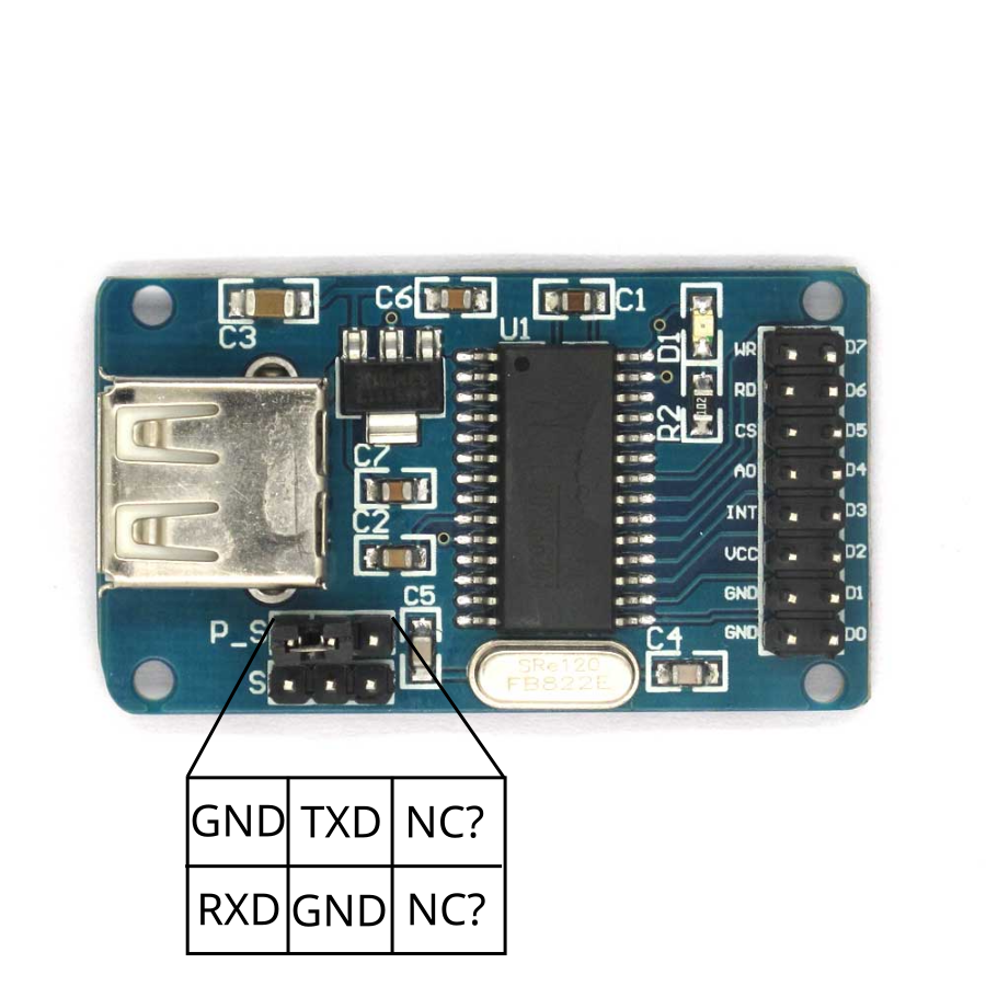

It has an undocumented header on it, which I've determined out the pinout for (See attachment).
It has a serial mode, which I'll use to figure out how the protocol works.

Update: That pinout doesn't look entirely correct.. check this link: ftp://imall.iteadstudio.com/Modules/IM1 ... 009001.pdf
That header seems to be where you select serial/parallel mode.

RE the pinout - I think my pinout is still correct, the TXD pin doubles as a switch between Serial and Parallel modes.

I got one of these recently, and I've noticed a bit of a data point. On the S and P_S headers, the two pins that are marked as no-connect in the images above are connected together, and apparently to nothing else. I've probed most of the connections on my board(mainly the ones connecting to ICs, rather than the passives), and there is no apparent connection. I've also run the Arduino test program linked to above using that connection, and it seems to work.
I'm not sure why they did this, as the only reason I can think of is to make switching between parallel and serial interfaces easier, but that's almost totally pointless when one can just remove a jumper on a 3-pin header. It does make sense, given that the header the jumper came on is labelled P_S, though. P for parallel, S for serial, and the positions correspond to where you'd put the header for each.
I think I'll end up using a parallel interface through a VIA, or make up an adapter to SPI-10, so I can use interrupts. Once it's put into USB Host mode, it sends a byte when I insert or remove a USB stick, and that makes writing a serial driver a bit hard, because the UART I'm using has buffers, and that extra byte would sit in there until a driver routine got called. When it did, things would go off the rails fairly quickly due to misinterpreted bytes.
I think that if the USB module can raise an interrupt, then I can probably handle it much more easily, because I can then know to look for it.
