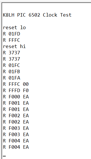

Here's an R65C02 reset cycle as monitored by a PIC microcontroller which is single-cycling the R65C02. The first column shows 'R' for 'read', the second column is the contents of the address bus, and the third column is the contents of the data bus (supplied by the PIC at the point when the reset vector is being read). I regret not collecting the <sync> pin status which would have shown the instruction 'fetch' cycles.
Hope this helps...
Cheerful regards, Mike

cbmeeks wrote:
What gives? Is it because the NOP takes two cycles and the program counter "stalls" during those two cycles?
Yes, the NOP takes two cycles. During cycle one, it fetches the NOP instruction. During cycle two, it does the no-operation and fetches (and discards) the next instruction. Then, on cycle three, it fetches that next instruction again (repeating cycle one). Repeat to nausea.
For a two-cycle instruction that increases the program counter once per cycle, try something like BIT #imm. Or, since you're on a 'C02, there are some single-cycle NOPs available.
Re: Why does A0 toggle at 1/2 the speed I expect?
or even something like LDA#$A9 which takes two bytes and two clocks.
