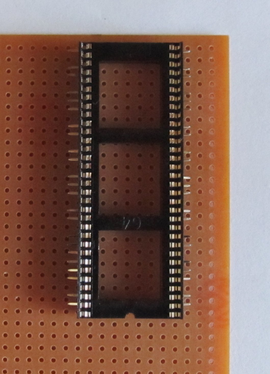

PostPosted: Tue Mar 08, 2016 6:27 pm
Posts: 197
The V9938 and V9958 are 0.75 inches wide too (the DIP Z180 is too, is that safe to mention here?). Which makes them more tricky to force fit onto a 0.1 inch board.
The best I could come up with was bending flat 7 of every 10 pins, and only pushing through the board the 3 that more or less fit the 0.1 spacing (1,4,8, 11,14,18 etc.)
I wasn't sure how sound that would be mechanically, so went with an adaptor instead.
That's one thing in the 9918's favour, it fits!
