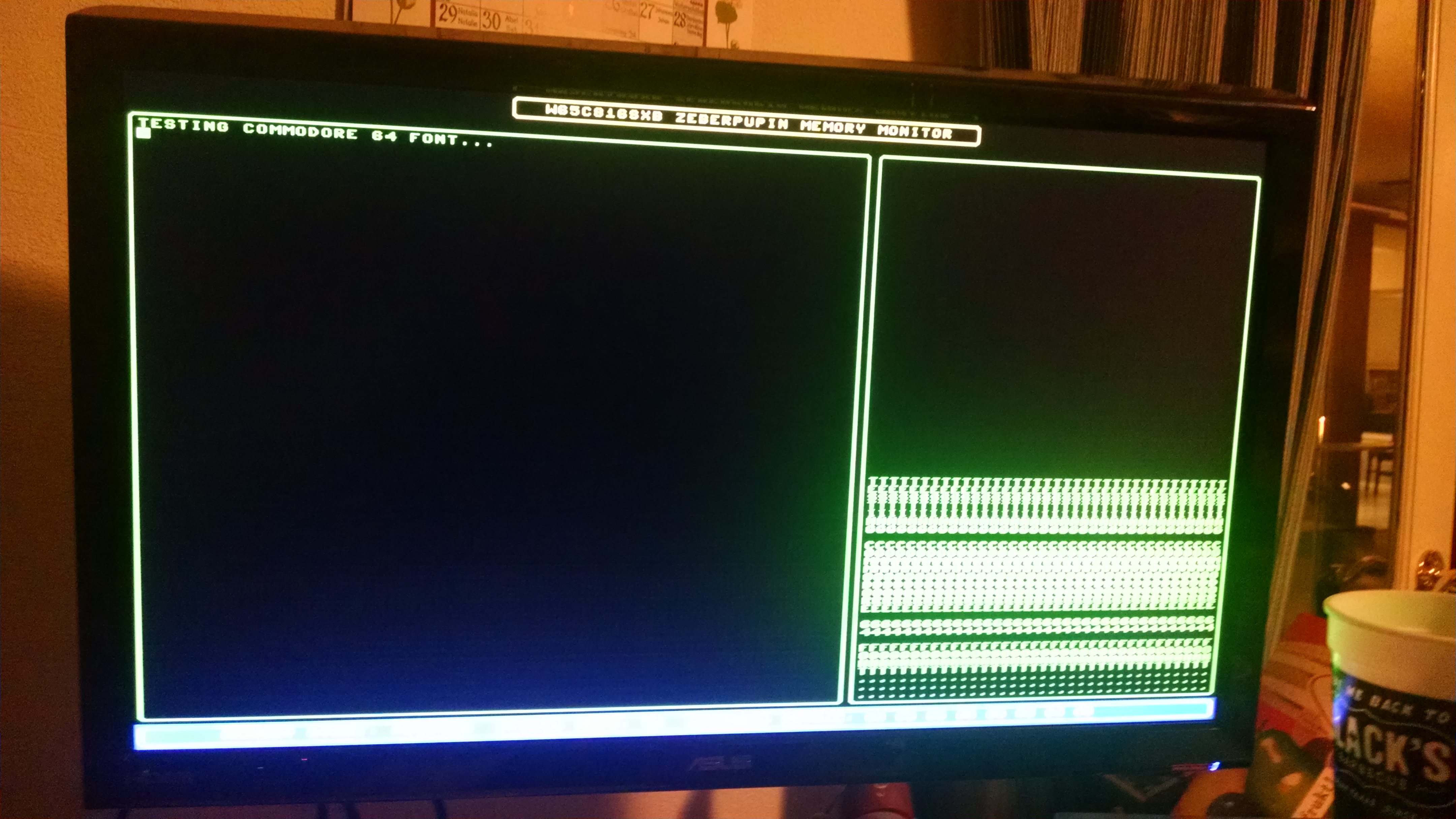

I modified the code to use 8x8 chars in stead and use a Commodore 64 Font...
This was a lot easier than adding color per characters.
If you still have your code and know where it is, I'm interested to see your font so see if it is different from the C64 Font.
Looks like the Commodore 64 does not follow the ASCII code so I need to re-arrange the characters...
I'll post some pictures once I have re-arranged the font.
PostPosted: Sun Feb 21, 2016 3:19 am
Joined: Fri Oct 30, 2015 9:49 pm
Posts: 54
Location: San Antonio, TX
The Commodore 64 font came out great, I now have a 100x75 screen area to play with.
The Font set I had didn't have the lower case characters but I can live with that.
I also had to move the Characters from position 0 to position 64 so I can use ordinary strings...
