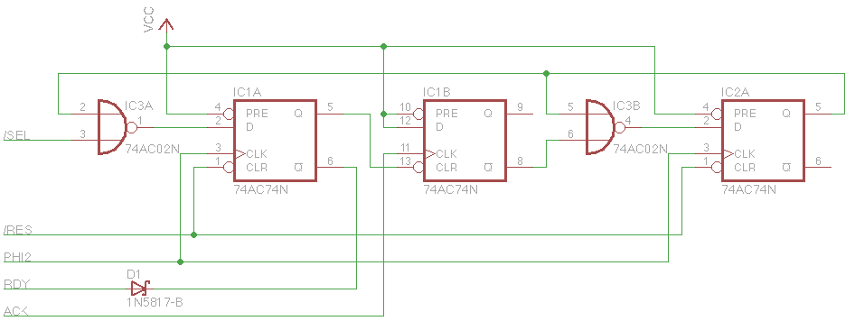

Hi Jeff,
thanks, indeed /RES and PHI2 are labeled the wrong way, here an updated version
File comment: Ready Signal Generator
Peter
