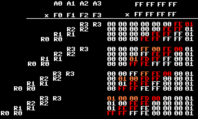

Just tried to implement above posted algorithm, but haven't been able to get a correct result yet. But with all the steps implemented, it's taking about the same amount of time as the built-in version. I'm using the smaller table-based fast multiply from codebase, maybe the 2k table version would be better, (I'd be using that routine anyways if I wanted add a 3D view to simulator).
BTW, the regular multiply takes about 2300 cycles including loading the accumulators.
PostPosted: Thu Feb 04, 2016 7:43 pm
Joined: Thu Jan 28, 2016 11:12 pm
Posts: 12
Here is what i have so far, seems to do a little over 1500 cycles. Uses the fast multiply from codebase, it's about a 800 cycle improvement over the built in one, though perhaps it could be optimized for multiplying zero bytes. Table generation and test code not included:

Here's what's it's doing, and an example of $ffffffff^2, the c64 prg below calculates 3.15151515^2.
fastm.zip [692 Bytes]
Downloaded 148 times
