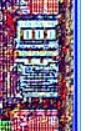

Just for fun ... I'm also guessing that the small three cyan rectangles on the right are the sequencer for the control unit, to provide up to eight cycles for an instruction.

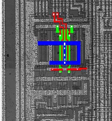

Just for fun, I had a good look at that area. In fact it holds 8 large inverters - looks like the databus being driven into the instruction pre-decode (*). As the outputs go immediately through some pass transistors (clocked by phi2) I'm not sure why they are so large. According to the giant schematic, the sequencer is just to the right of this structure, in the photomicrograph, or just to the left in the image you posted.
Here are the three cyan rectangles, on the right edge:

And here I've highlighted two of the inverters, with the following pass gate, and a little of the VSS net:
(I'm not endorsing MSpaint as a layout tool.)
Here's the corresponding left edge of the circuit diagram:
Edit: (*) But I don't see D4 and D7 being taken off from the inverters before the pass gates, as shown in the schematic. I'm tempted to distrust the schematic, but I'm not sure what's going on. Is it even safe to take unclocked signals north into that cloud of logic whose output is latched on PHI1?
