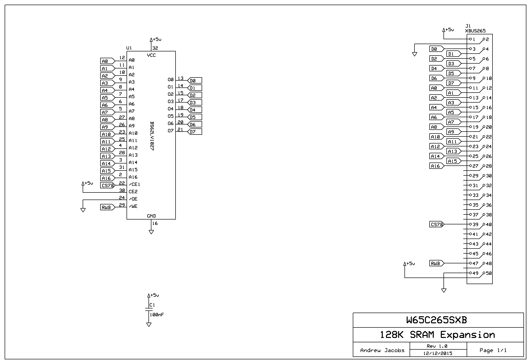

The slower clock speed on the W65C265SXB makes it much easier to play with the hardware. I couldn't find my 512K SRAMs but I did turn up a 128K so I added it using jumper wires and a breadboard. Should be plenty to play with until I locate the bigger chips.
File comment: Loads of wires
This shows the connections.
File comment: 128K SRAM Expansion
I have some spare 128K Flash EEPROMs I got to backup the W65C816SXB firmware so I'm going to populate the empty ROM socket as well.

I've started a port of my SXB hacker code to the 65C265. The basic commands and XMODEM appear to be working but erasing and loading into the flash ROM needs some more work.
First cut of the source files are on Github here https://github.com/andrew-jacobs/w65c265sxb-hacker.
I'm rearranging the code and adding some conditional bits so that the 65C816 and 65C265 will use a common module for the commands with hardware related bits in a separate module. Its a work in progress at the moment.
Andrew Jacobs

PostPosted: Tue Jan 12, 2016 12:33 am
Joined: Sun Aug 30, 2015 10:23 pm
Posts: 36
Nice work on the daughter board, I have an EagleCAD schematic and layout for a similar board with 4 x 512KB SRAM and 512KB of flash, but never finished it.
What did you use for layout? I'm curious about positioning of the header, etc.
I have written a Python class for communicating with the firmware for doing uploads of code and the like for non-Windows folks. I used that combined with a Makefile that can assembly code in ca65 and then upload it to the system to execute. I will try to clean it up and get it up on github or similar.
That board was done with DesignSpark, the free PCB design tool from RS components.
Andrew Jacobs
