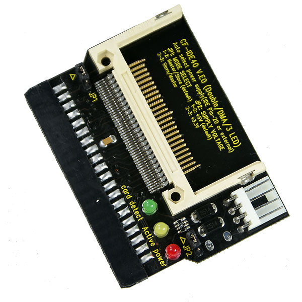

Using the normally "keyed" pin 20 as power is a little trick done on some IDE->CF adapters, to save a Berg. I make use of this on my own PCBs to save a power connector. I can always pull out the pin if I wanted to attach a regular PATA IDE cable for a hard disk.

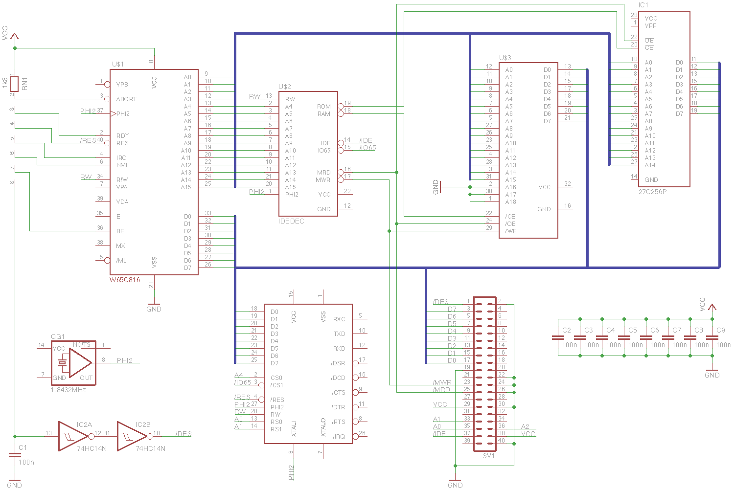

Here the current schematic.
File comment: CF Card System

Well, I'm no expert on CF cards, but I still think the theory of a voltage drop across the input-protection diodes bears investigation. For one thing, the issue you're facing is pretty clearly related to power. And, the adapter in the photo Aslak3 posted above has a jumper that pertains to 3 volts vs 5 volts. Granted, most CF's may work with 5V or 3V3 as you say, but apparently they don't just automatically accept whatever voltage they get.
Just thinking out loud...
