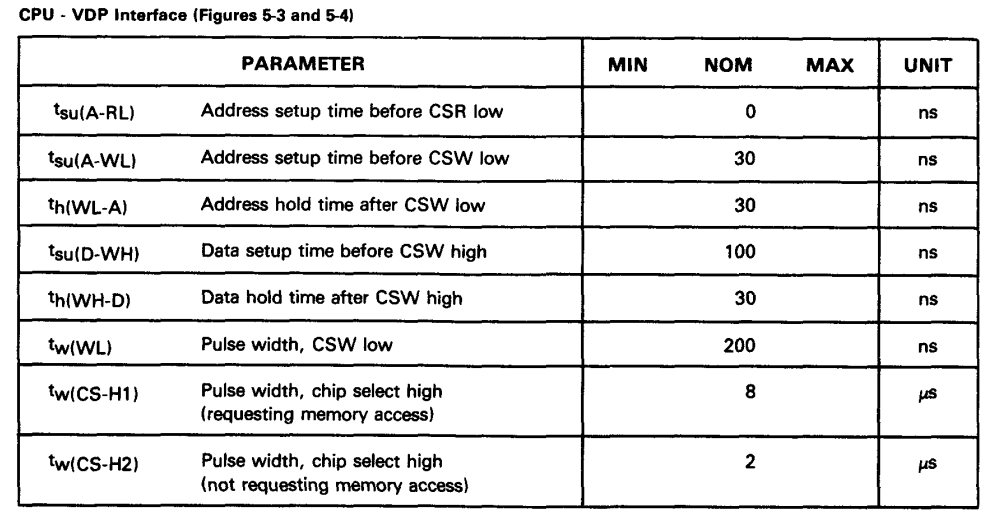

I'm using a UM6502 chip. This question arose just when I was devising the software part before interfacing the actual hardware.
TMS9918 interfaces to the cpu with following pins,
MODE : Used to differentiate between VRAM access and Register access
/CSR : Low active read signal
/CSW : Low active write signal
CD0..CD7 : Bidirectional data bus connection
/INT : Interrupt generated every screen retrace
For read & write accesses datasheet states that
"The CPU interacts with VRAM memory through the VDP. The amount of time necessary for the CPU to transfer a byte data to or from VRAM memory can vary from 2 to 8 microseconds."
Even 2 microseconds is too slow for 6502 which actually does memory access much under half a cycle (0.5 microseconds)
What should one do in this scenario? Use latches and extra logic for timing and use NOPs when accessing the chip? Use peripheral i/o chips? Or is it possible to accommodate for it solely in software?

I checked the datasheet and it looks like you'd need some hardware support, to stretch the clock or at least to stretch the access. From p82 of http://www.cs.columbia.edu/~sedwards/papers/TMS9918.pdf
Re: Interfacing stock 6502 to TMS9918
@BigEd : Thanks.
It's interesting how did this guy that used 65c02 in his project never faced this issue.
https://hackaday.io/project/5789-6502-homebrew-computer
I don't think 65c02 will help in this regard since VDC doesn't acknowledge an access with an extra output pin that can be used to stretch the clock or stall the cpu.
I guess the problem is only faced if one tries to read from memory interfaced to VDC which there is not much need to.

From the datasheet, 2-4:
"The VDP requires approximately 8 microseconds to fetch the VRAM byte following the last data transfer, and 2 microseconds following following address setup."
This matches my experience of using the V9958 on my 2MHz E-clocked 6809, which had no problems keeping up. I've seen others eg. Matt Sarnoff's Ultim09 use the 9918 in a similar clocked computer without wait-states or other complication. The Colicovision, which used the TMS9918 and a Z80 had no special logic, just regular decoding.
Reads and writes are double buffered, in and out of the VRAM. When you are asserting to read, the VDC is pushing the byte which was read out of the DARM and into the VDC on the previous read. There is no reason why it would be slow because of this buffering. That table in the datasheet says one thing. But the text says something rather different.

Hi Folks, BigEd posted a question about this to me, as I am the guy on the Hackaday link above with a working 65c02 driving a 9918.
So I am not using any special wait states, clock extending etc. circuitry at all, it is not required (as alluded by aslak in the last reply). But I am only running my 6502 at 2.68Mhz at the moment, not sure it will drive the VDP reliably above this.
I don't have a schematic, but simple to describe:
- 6502 D0-D7 connected to CD7-CD0 (remembering that the bits are numbered in the opposite sense to the 6502)
- 6502 A0 connected to MODE
- For chip select, CSW and CSR remain high when the VDP is not to be selected, else R/W connected to CSW, with the inverted signal connected to CSR. To do this I have a decode which outputs Low when the VDP is addressed by the 6502, and this decode is inverted and then NANDed with the R/W and inverted W/R signals before being fed to the VDP CSW and CSR line.
This works because:
- The timing requirement for CSW is 200ns nominal. As the 6502 accesses on half cycle time, then I guess this means my total 6502 cycle time cannot be more than 400ns. This is 2.5Mhz, a little bit slower than the 2.68Mhz I am driving the 6502 at - but not sure whether the term 'nominal' means that CSW could be pulse low for a significantly shorter time.
- The timing requirement for CSR is that data becomes valid no more then 150ns after CSR is low. This is a shorter half cycle than CSR, potentially means 6502 access could be faster for read rather than write.
So the manual then has some words about 2us to 8us cycle time. I think this is misleading because I believe the VDP works as follows:
- the VDP must internally latch the access based on MODE, CSR, CSW and latch any input data present on CD7-CD0
- the VDP then takes between 2us and 8us to perform its internal operations to set or read VRAM
- additionally, the VDP must be reading the first byte in readiness when it is provided a VRAM address to start reading from
Therefore, what is needed is that between 6502 accesses, one needs to wait between 2us and 8us (depending on the screen mode). I just use a bunch of NOPs.
Here's why I think the internal operation works as above. When I was first trying to get the VDP to work, I didn't have enough NOPs. The operation of the VDP is that one can send the VRAM address and then do successive reads or writes which auto increments the address pointer. When I didn't have enough NOPs, I would end up writing to the same VRAM address (which I could tell because my font initialisation was sometimes creating odd looking characters). When reading too fast, the VDP just gives the last successfully read VRAM byte on CD7-0.
There is nothing of note to show in the code. Basically to read a byte, I use LDA MODE0 followed by 5 NOPs. Then I can do another read and the VDP will give me the next byte.
I still don't know the difference between a nominal and a minimum timing requirement, and whilst I think a 6502 at significantly more than 2.5Mhz will be too fast to interface directly, I haven't tried it - but one of my thoughts is to try and drive around 4Mhz to see what occurs (but I can't do this yet as have other things to upgrade which won't work at that speed).
I hope that helps - ask away if I haven't made sense!

@dolomiah, @Aslak3 : Thanks for all the precious information. Now it's all clear for me. 2us to 8us access times actually relevant to software side as I see. I don't need to delve into stalling the cpu or stretching the cycles to get the access times right.
