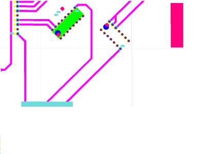

6) I am posting a diagram of my "multilayer PCB hack". Do let me know if the idea is insane, i.e. can't work. It is just two double-sided PCBs screwed together with a blank (no clad) perf board between them. It should work and should give me a decent ground plane (I think?).
I suppose I could hire out the PCB work. If I get my circuit running, I could do a second one and hire it out to "make it look pretty".
Fortunately, the price of custom, commercially made PCBs has come down within reach of the hobbyist now. Going this direction rather than making your own, you can save time, get a much more reliable product, and get density that you can't achieve at home in a PC board.

Ran out of computer time yesterday (because I prattle" at the keyboard);
I meant to post the following schematics, so here they are.
Also, I awoke at 4 am and read the old posts (from this thread), and wrote a short response. I almost read through all of them. So, I might comment (tomorrow), as I am quickly running out of time today (Star Wars movie, today; let's hope Disney doesn't ruin the franchise! I have fond memories of my favorite space opera....childhood, etc. Where were you for Star Wars?).
OK, I had hoped to post something semi-intelligent about the following four schematics, but can't. My ride arrived, it is 4PM, the movie is at 6:15, 5 minute ride to town; 1 hour wait because it is STAR WARS.
Here are the schematics, I have to go.
NOTE: One short note is necessary; this is the old circuit; I am going to scrap it. Closeup of the decoder ICs. Did not bring Phi2 into the circuit, but probably should have. 74HC138 and 74HC11 (3 input AND).
