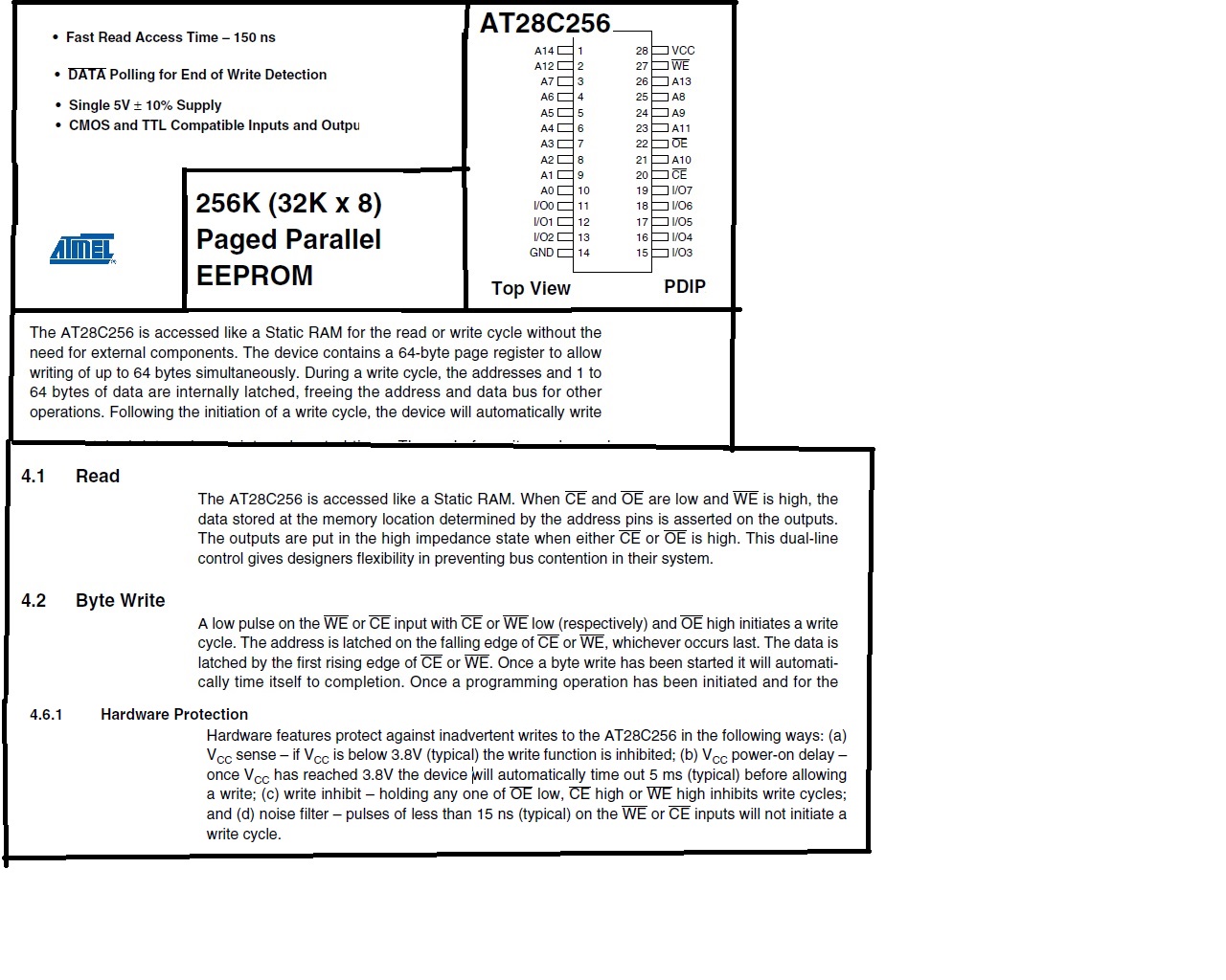

So, here is my EEPROM pinout, synopsis/description, and part number.
" If your RAM or ROM has its /OE permanently tied low and the '816 is in a read cycle (RWB is high), the RAM or ROM when selected will drive the data bus. ~BDD"
I think CE/Low, from decoder circuit, and WE/High (I think I tied this to RWB pin from 65816? I forget?), will read from ROM. OE/ tied low might not be a problem? but I will check and recheck the timing diagram. You are probably correct (I have been having trouble getting my head into "the space" of timing diagrams; I am a musician, so I have no good excuse. Just have to try harder to concentrate on it. Maybe practice makes perfect?)
I think I will socket the Atmel EEPROM, and thus, I can remove it to write to it. So, with CE/Low, and WE/Low (again, from RWB from 65816?) OE/ would have to be high to initiate a write cycle; I won't do this (pull OE/ high) while its in the socket, so writing to it by accident won't be a problem.
I think inadvertant writes wouldn't be a problem; but inadvertant reads, i.e. bus contention might? I dunno. As I said, I will check and recheck the timing until I understand it.

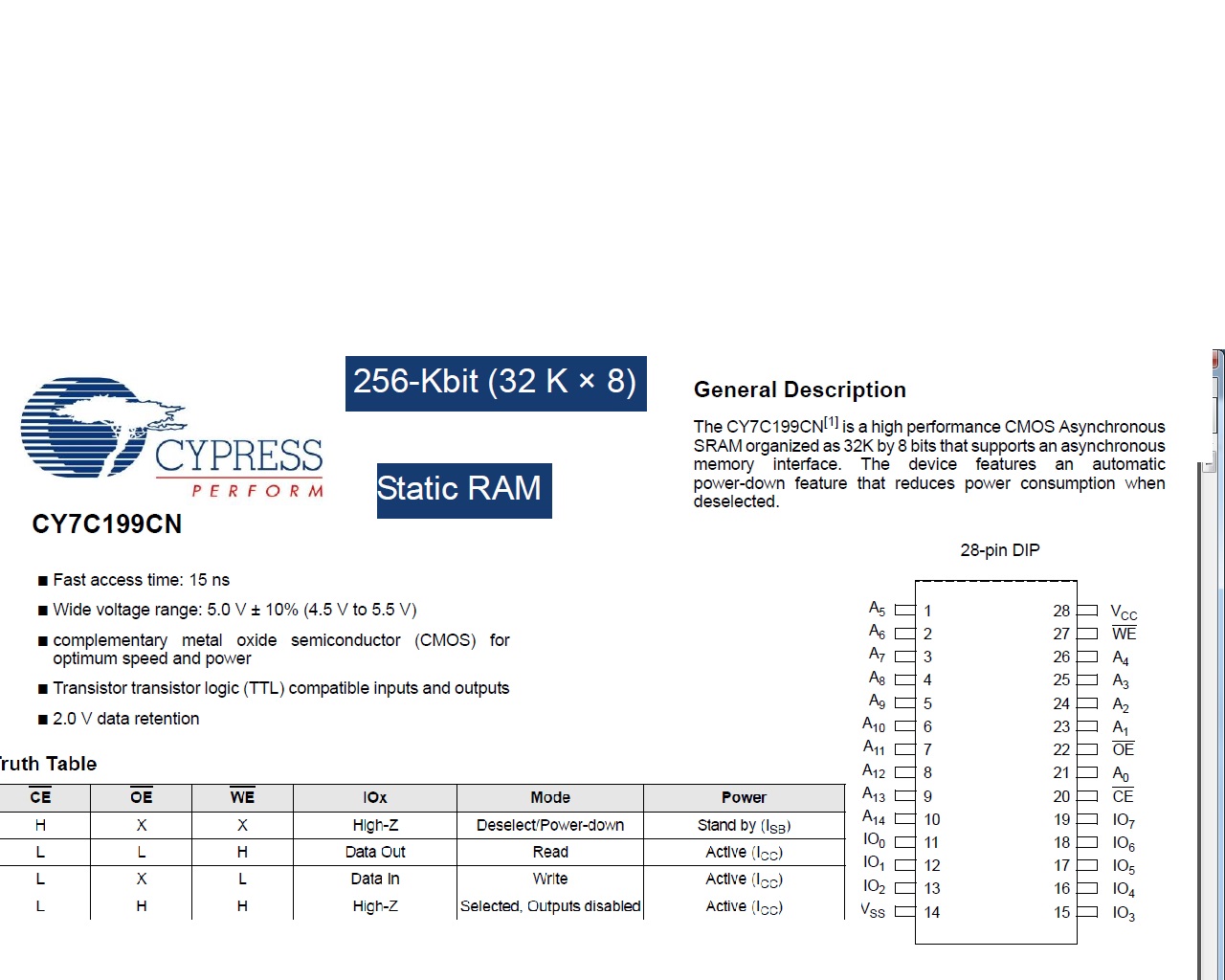

As for the Cypress RAM, I will attach a synopsis, pin diagram, and part number, too. Maybe I am missing something (probably, I am missing something) but the truth table seems to indicate that OE/ is usually "X", which I interprate to be "Don't Care"? The only time it matterts if OE/ is high, is if I want a "bus disable state"? Perhaps I want this, sometimes?
Again, I can check the timing diagrams again, and obsess over them. I definitely will. But, If I do so for a month or two and don't get anywhere, I'll have ot just try it and hope I'm not "too stupid to compute", with hardware.

The Cypress page you show does mean OE\ is a "don't care" when WE\ is low or CE\ is high.  That's pretty usual.  I don't doubt that BDD's mentioned scenario exists somewhere in the world of RAM, but I haven't seen it myself.  Regardless, you always have to consult the truth tables and timing diagrams and charts to make sure you're doing things right..

|| represents logical OR and && represents logical AND. These are borrowed from ANSI C.
Just so you understand what these chip control symbols mean, /CE is "chip enable," and may also be written as /CS, meaning "chip select." /OE means "output enable" and /WE means "write enable." As with /CE, other notations may be used, but mean the same thing.
Using the Cypress CY7C1049D static RAM as an example, the control inputs are designated /CE, /OE and /WE. You would assert /CE when the address placed on the address bus by the MPU is one that is somewhere in RAM. This should occur as soon as the address bus becomes valid, which is sometime during the Ø2 low part of the cycle.
When Ø2 goes high, glue logic would "translate" the MPU's RWB output to assert /OE if a read cycle (RWB is high) or /WE if a write cycle (RWB is low). Note that neither /OE or /WE should be asserted until Ø2 is high. This is especially important during a write cycle, as the address bus can change during Ø2 low, which could result in a wild write if /WE is asserted at that time.
Also, during Ø2 low, the 65C816 places the bank address on the data bus. If /OE on the SRAM is asserted at that time both the '816 and the SRAM will attempt to drive the data bus, causing contention and a possibly-bogus bank address.
If you carefully inspect the timing details of the Cypress SRAM, you will see that the time required for it to generate output varies with the order in which you assert /CE and /OE. As the 65C02 and 65C816 both place a valid address on the address bus during Ø2 low, and maintain that address until after the next fall of the clock, best performance is achieved by asserting chip selects as soon as the address is present (and the '816 indicates when a valid address is present with the VDA and VPA outputs). With /CE asserted the SRAM will respond most rapidly when /OE or /WE is asserted. If you tie /OE low and control the SRAM with /CE alone, the time required for output to appear after selection will increase.
The CY7C1049D data sheet doesn't specifically state what happens if /OE and /WE are simultaneously asserted (but see figure 7 on page 9 for some confusion in that regard). In some other SRAMs, such as the 128KB unit I used in POC V1, the data sheet indicates that simultaneously asserting /OE and /WE will result in undefined behavior. Hence POC asserts /OE only when the SRAM is accessed during a read cycle and, of course, only when Ø2 is high. As I needed separate read and write control signals for use with the SCSI host adapter and the DUART (the latter which requires exclusivity with the read and write control inputs), no extra circuitry was involved in controlling the SRAM in this fashion. Also, with no reads allowed during Ø2 low, I eliminated any possibility of data bus contention with the '816.
The Cypress page you show does mean OE\ is a "don't care" when WE\ is low or CE\ is high. That's prety usual. I don't doubt that BDD's mentioned scenario exists somewhere in the world of RAM, but I haven't seen it myself. Regardless, you always have to consult the truth tables and timing diagrams and charts to make sure you're doing things right.
I quote from page six of the ON Semiconductor 28C256 EEPROM data sheet:
    A write cycle is executed when both CE and WE are low, and OE is high.
Similarly, from the Atmel 28HC64 EEPROM data sheet, subsection 4.2:
    A low pulse on the WE or CE input with CE or WE low (respectively) and OE high initiates a write cycle.
In both cases, it is required that /OE be high while writing.
The data sheet is at http://www.cypress.com/file/42806/download .  The truth table is on page 11, and the OE\ column has X's for "don't care" where WE\ is low or CE\ is high.
The 28's are EEPROM though, not RAM.
Yes, but take another look at the heading for figure 7 on page 9. It seems to be implying that /OE should be deasserted when /WE is asserted.
That's because the processor could potentially be putting data on the bus before WE\ goes down in that diagram, so you wouldn't want the outputs enabled.  After WE\ goes down, you could also bring OE\ down if you wanted to, but you'd have to go out of your way to do it, which wouldn't make sense at that point.

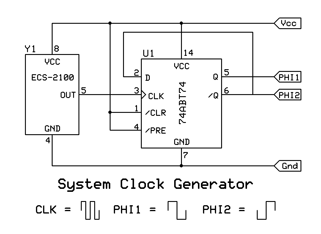

Whoa; just noticed this morning, Garth's primer ( http://wilsonminesco.com/6502primer/ClkGen.html ) mentions "Read-not-write" pin for the 6502 and its difference from RD/ and WR/ pins. I'll double check the '816 schematic; "RWB" if I remember correctly.
Also, I just noticed that a "single board '816" ( http://sbc.bcstechnology.net/ ) has been tried and successfully implemented, and thus "meticulous" documentation of my attempt is unnecessary. I am curious how he did it so neat and clean, and compact, as my design is anything but.
I will continue on, in BDD's footsteps, and try to push past the "known" into the unknown.
(I note that he recommends 74ACxx logic in some places, where there is some debate on this forum. I am foolishly and naively stumbling through the timing diagrams, as I presently write, and so I can offer no comment on slew times and such of the 74HCxx or 74ACxx family).
I will have to check the other parts of the 6502.org website. I have neglected them and ignored alot of the completed projects. That is the fun part. To see the completed projects and see why people did the things they did and made the decisions they made.
I think I have probably graduated from Garth's page; not because I understand everything in his primer (I do not!), but because I have stumbled across the "65C02-vs.-65816" thing, five or ten times already; I am a '816 guy (if only because I naively bought the part 5 years ago, and it presently collects dust--metaphorically--in my closet), and should seek out the successful '816 projects. The data bank addressing (on the data pins ! Arghhhh!) alone is enough to give me a headache.

And one final, short, word for today. I was checking the specs on the data sheets and--I think Garth alluded to this earlier--the 6522 and the 65816 MIGHT (I must triple check) accept the H and L levels from the digital video output (D0 through D11) pins of the KAC-9628 image sensor. So, I guess I can get a different voltage supply (different board even? A "Camera Headboard", I think they call it!) for the sensors (i.e. 3.3V) and use 5V for everything else.
Will save some cash (and time and energy and thought) if I don't have to look for RAM and ROM to run on 3.3V. The cash isn't all that much; maybe buy them just in case I have to change my mind later?
Still "sunk" when it comes to my need for massive amounts of video data. (I forgot to mention; the image sensors are "programmable" for 8, 10, or 12 bit depth, i.e. in the Analog to digital conversion of pixel values. Also, I neglected any CFA (color filter array) interpolations.... I don't remember/know if that interpolation is done by the Altera/FLEX-PLA or if that is done "on-chip".).
