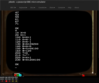

I'm pleased to report that, with Mike's assistance, I've got his latest VTL02B version running on a Beeb - or at least, on an in-browser emulation of a Beeb. Here it is with Klaus' earlier, shorter prime number program:
You can run the interpreter in your browser using this link. (The keyboard mapping is idiosyncratic, to help people play games - use the menu thing to choose between two modes. I tend to mash about until I find the character I need.)
Edit: this emulation doesn't have support for copy and paste at present, or I think for load and save, so there's an incentive to try only short VTL programs. Also, it doesn't react well to Escape or ^C - that's something I should be able to address.)

Congratulations for getting it working, and for the longest URL I've ever seen! Crtl-C seems to work as expected over here, but ESC causes an instant crash.
Could it be that the Beeb's OS doesn't tolerate resetting the hardware stack at every OK prompt, a strategy that VTL02 uses to abort out of a few different sticky situations? I admit that the Apple 1 and Apple 2 are the only platforms on which I did extensive testing, and they didn't seem to mind at all, but they could be a lot simpler than the Beeb in that area.
Mike B.
[Edit: Oh, I see ... Ctrl-C only seems to work at the command prompt, not during a newline print check.]

I think I originally commented out the stack reset, but I see it's still there in the present version. I don't think it should cause trouble - running in user code we know we're not in the middle of an interrupt or an OS call. We can't RTS to Basic anyway because we overwrote its zero page allocation. (We can restart into Basic anyhow.)
I haven't touched the code which aims to do abort handling or checking for a current keypress - the OS provides a flag to say that ESC has been pressed, which is probably the most appropriate approach on a Beeb.
Would it be best to ensure that VTL only sees input characters within the range it expects? That is, printable characters. I suppose there's return, escape, erase and line kill to deal with too.
As a nice side-effect of not taking over the machine entirely, the cursor keys and Copy key act in a Beeb-native way, which makes it easier to edit an existing program - if it's visible on-screen.
