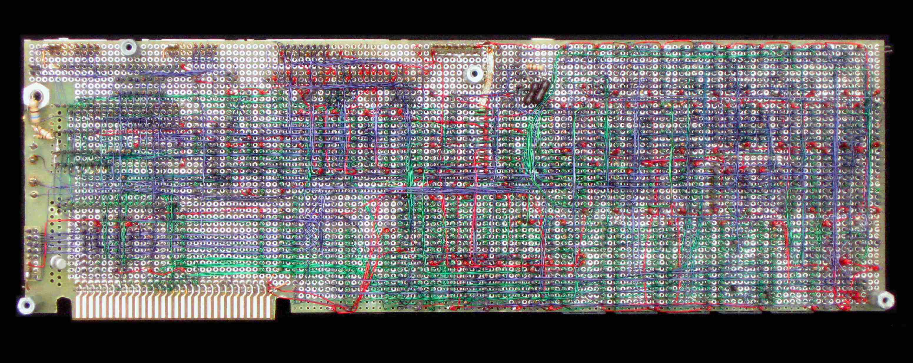

PostPosted: Fri Sep 25, 2015 1:34 am
Posts: 690
I have been cleaning up the wiring in my 15 minute spans of free time, and the board is starting to look good again.
The 44 remaining long wires are the IO lines, each of which basically toggle a bit to register some data.
The IO lines will soon be multiplexed to work with the 6502 using an untested scheme I came up with.
The next step will be to add the multiplexer into the last bit of free board space and then run a final test with the AVR.
Once the multiplexer is proven to work, I plan to swap in the 6502, using an AVR to boot load it's SRAM as I debug.
The other 24 breadboards are on order, and this will double the size of this board so I can start on the Sound System.
The board as of tonight, after cleaning up the last few control lines...
Here is a huge image of the board in 4000x2000 resolution...
http://lucidscience.com/temp/vt93l.jpg
I am looking forward to getting the 6502 installed into Vulcan-74!

PostPosted: Mon Sep 28, 2015 2:25 pm
Posts: 690
Today I spent an hour optimizing the circuit.
Much like optimizing assembly, you can often use left over gates to make IO either quicker or more simplified.
For instance, I had an IO line that would disable the bus between the Sprite or Playfield memory by setting the OE line on a 74HC574. I managed to get rid of the need for an external IO line by connecting the OE through a unused inverter and then to the 74HC74 that controls the state of the GPU. So the result was hardware optimization!
I also removed all of the long IO wires, and ran them nicely along the board to a free section of breadboard I now call the "IO Port". This puts all 44 required IO lines into 2 rows of 22 on the breadboard in one single location. When I complete the multiplexing section, this will make connecting all of the IO lines much easier.
The next step is the multiplexing, which will force all IO to appear in a way that will be compatible with the 6502.
I have a plan in place, and will verify operation one last time with the AVR since it is still connected.
If all goes well, the 6502 will find a home next week.
It's still yelling out "I'll be back!" from the other board, clocked at 28.626MHz while playing the Terminator audio sample.
I am looking forward to seeing Vulcan-74 under 6502 command, and know that the 6502 part of this project will be a breeze!
Compared to what was accomplished in the Video Section, the 6502 timing and IO will probably be the easiest part of this project.

PostPosted: Mon Sep 28, 2015 10:42 pm
Posts: 690
Wow, cleaning up all of the wiring took longer than most of the design sessions I had!
Every single IO line is now connected to a single section of the board, and all wiring is cut to length or wrapped in bus bundles.
The only messy part left is the Atmel XMega, but it will soon be moving out to make room for the 6502.
It looks like there might be enough board space for the 6502 and multiplexer, but it will be a squeeze!
I am almost done drilling and sanding the plates to make the other equal sized board for the sound system as well.
Here is the state of the board as of today...
The completed Video System ready for the 6502!
All of the new green wires are the IO lines, which lead to 2 rows of 20 pins on the board.
I will do the same thing on the Sound Board so that the IO lines are close to the multiplexers.

PostPosted: Tue Sep 29, 2015 12:36 pm
Posts: 690
Yes, it works perfectly. I move wires one at a time while the unit is powered and generating video! (visual debugging).
Cross-talk, capacitance, and propagation delay are the 3 things I consider first before adding anything to the board.
As random as it looks, there was some real planning that went into the chip placement and wiring bundles.
I never think of a gate as something with 2 inputs and an output, I think of it in terms of the complete path from one wire to the next, with ones and zeros all racing each other in an attempt to either collide at the end or show up at different times. I have also calculated a 25% safety margin for all propagation delays based on the worst case scenarios stated in the datasheets. Although I am just a weekend hardware hacker, I still like to think that my project is working due to good planning, and not just dumb luck!
As for power consumption, last time I checked, the board was only half the size, but it was only pulling 300mA or so. Next time I power up, I will check the current power usage. For power, I am using a 2A wall-wart from an old Linksys router.
The second (same size) breadboard is almost ready as well, so that will double the size of this project, making room for the audio section.
I am now studying the 65C02 timings so that I can push things to the absolute limit, minus a small safety margin.

Oneironaut wrote:
[ regarding Peter's ROMulus ] Always great to see a tangle of wires generating crisp video!
The "tangle of wires" below may interest some readers. It isn't nearly as pretty as Vulcan-74 but it does generate crisp (albeit monochrome) video. Also like Vulcan, it features a heavy emphasis on 65c02 and on Retro, 1980's-vintage parts. It was built in the 80's, back when the stuff wasn't Retro!
A minimalist kludge which I adapted from Don Lancaster tricks the 'c02 into doing double duty as a DMA controller that burst-fetches video data from RAM. (The tangle of wires doesn't look minimalist because much of it is for 65xx instruction set extension. Discussion thread here.)
