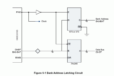

26-33: Data pins D0-D7/Address pins BA0-BA7 (Bidirectional). The 65816 can access 16 MByte of data, which requires 24 address pins. However, only 16 (9-20, 22-25; see above) are dedicated to the address. The other eight share double-duty with the data bus. Roughly: With the 6502, when PHI2 (Clock, pin 37) is high, the data is driven on the data bus (fans of Star Trek Next Generation will remember that "Data always takes the high road"). When PHI2 is low, neither the processor nor the system drives the data bus. This means there is "dead time" between individual reads and writes that is nominally half of the cycle. The bus is relinquished to the system. With the 65816, there is no more dead time: When PHI2 is high, the processor drives the data bus as usual. During PHI2 low, the processor drives the Bank Address to on these pins. This happens even in emulation mode, though only zeros are fed to the system.
(Note the address and data buffers can be switched off externally by asserting BE ("Bus Enable", pin 36) so that other devices can use the busses. See below for further discussion.)
There is a standard circuit in the 65816 data sheet for dealing with this situation:
For the data bus, use a buffer such as the 74ABT541, gated to high-Z-state when PHI2 is low. For the bank address, use a latch such as the 74ABT573 or 74ABT245 when PHI2 is high. If you only access the "original" 64 KByte bank, you don't need the latch. Note that this all becomes slightly more complicated because of the VDA/VPA pins. See the discussion about qualifying this circuit with those signals in this thread.

26-33: Data pins D0-D7/Address pins BA0-BA7 (Bidirectional)...There is a standard circuit in the 65816 data sheet for dealing with this situation:
...Note that this all becomes slightly more complicated because of the VDA/VPA pins -- see above.
It should be noted that WDC's circuit may not work as expected due not being qualified by VDA and VPA. The state of the MPU's D0-D7 pins is undefined when the expression VDA | VPA is false (where | means logical OR)—that is, during an invalid memory cycle. If the MPU is in such a state the above circuit will potentially latch garbage when Ø2 goes high. Complicating matters, if the MPU is being held in a wait-state due to RDY being negated, WDC's circuit will repeatedly unlatch and latch as the Ø2 clock cycles. Either of these conditions may trigger anomalous system behavior.
Also, the use of the inverter on Ø2 to condition the E input on the latch causes the latch to close slightly after Ø2 goes high, due to the inverter's prop time being added to the latch's internal response time to E's change of state. This may create a timing "race" condition in which D0-D7 may be driven with data slightly before the latch closes. This can be avoided by generating a two-phase clock from a D-type flip-flop (mentioned below), with one of the flop's Q outputs driving E and the other Q output driving the MPU's Ø2 input (as well as the Ø2 inputs of any 65xx I/O devices in the system).
It seems to me the WDC circuit will latch invalid bank addresses just fine. :) Is that a problem? VPA=VDA=0 tells us when to inhibit memory and IO due to an address that can't be trusted. Every address is 24 bits, and the bank address is simply the MS 8 bits of that. I don't see any advantage if the WDC circuit were qualified by VDA and VPA as you suggest.
[Edit:] IO and memory are expected to retain their contents, which is why they require VPA/VDA's protection against invalid accesses. But there's no requirement for the latch to retain its contents. Updates are continuous, each relevant only to the current bus cycle. I guess that's what I should've said in the first place! :roll:
Oh, I don't doubt that the WDC circuit will latch whatever shows up on D0-D7. We're thinking in terms of memory and I/O, but what if the glue logic itself reacts in some unanticipated way to a bogus bank address? That is something the designer might want to contemplate.
PostPosted: Sun Aug 16, 2015 4:14 am
Regarding bank addresses, "latching whatever shows up on D0-D7" is the full extent of that circuit's job description, isn't it? It seems to me that as long as the circuit succeeds in doing that then it's satisfactory.
If your concern is glue logic then it was confusing to instead criticize WDC's circuit (which can't be expected to prevent dummy bus cycles -- we're stuck with 'em!). But I'm happy to agree we need to keep our eyes open for unanticipated reactions.
I hope no-one overestimates the prospect of using VPA and VDA to qualify the enable input of the latch, keeping it low during dummy cycles (VDA=VPA=0). Although that will prevent an invalid bank address from appearing in the latch during a dummy cycle, what will appear instead is the leftover bank address from the previous cycle.
That means the bank address is running a reproduction of the previous cycle -- while other signals such as R/W and A15 - A0 are running the actual cycle (the dummy). Even if those other signals were also reproduced, it's still doubtful whether you'd want that cycle overlaid, glue-wise, on the dummy cycle. (For example, if the previous cycle triggered a wait-state, do you want that behavior for the dummy? Probably not.) To be attractive, the idea of qualifying the latch with VPA/VDA needs to offer a desired behavior and compare favorably with alternative remedies which are quite simple. I certainly wouldn't view it as a magic bullet or a routine precaution. [Edits...]
