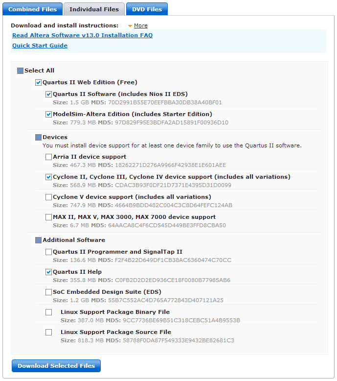

Hi Grant,
I've been collecting components slowly and just received my USB Blaster today so I'm getting closer. Just a couple questions, please?
1> Which Quartus II 13.0sp1 components do I need to download?
2> USB Blaster uses which connector on the Cyclone II board? AS or JTAG?
Thank you.
Cheerful regards, Mike

Hi Mike.
All you need are the core download ("Quartus II Web Edition (Free)") and the cyclone devices ("Cyclone II, Cyclone III, Cyclone IV device support (includes all variations)").
You can "un-tick" the other devices unless you want them.
Very big download, unfortunately. Thankfully I am on a 76Mbps link
Regarding the connector, the JTAG is the one for quick programming (and the default set in Quartus) to allow a configuration to be uploaded and to remain until power-off. The "Active Serial" port is used when you want to store the configuration onto the on-board flash ROM so that it will power-up with that configuration without needing to upload it to the board each time.
So, JTAG is for messing about with, and Active Serial is to keep it
Does the Quartus download screen below look ok?
Thank you, Grant.
Re: Build your own "pick and mix" FPGA computer - online
No, to use JTAG plug the blaster into the relevant port, then swap the connector to the AS port if you want to use active serial. The USB Blaster is used for both.
Yes, the download screen is what is needed, but you can un-tick the modelsim if you won't be using it (not needed for development).
