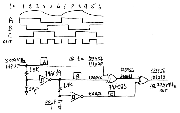

One way that comes to mind is:
The value of the 1.8K resistors will need to be variable (perhaps start with 2.5K trimmers) to adjust for the size of the hysteresis in the 74AC14 Schmitt-trigger inverters and variations in the capacitance of their inputs and of the 22pF capacitors plus traces, sockets, etc.. Adjusting while eyeballing the waveform on an oscilloscope will give an accurate-enough duty cycle.
The very top waveform shown would be at the input of the first Schmitt-trigger inverter. (I'm not suggesting looking at it on the oscilloscope, as the scope's input capacitance will have a significant impact on timings.)

hey thx Garth, that looks doable. Are the caps okay being ceramic or should I use a mylar or other?

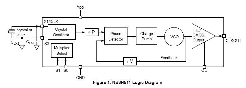

Another option for you, lenzjo, is the Phase Locked Loop (PLL) approach. A voltage-controlled oscillator (VCO) generates the high frequency used as the output. This output is also divided (by three, in this case) and compared with the reference -- 3.579MHz in this case. The result of the comparison is used to continuously trim (control) the operating frequency of the VCO and keep it on spec (ie, triple the reference frequency).
If you had to build all that yourself then it would be a lot more work than Garth's circuit. But PLLs are so handy they have been made available as all-in-one IC's. Attached is a datasheet for an example of such a product, one of many which are available. I found this one by using the product search on Digikey under Integrated Circuits (ICs) > Clock/Timing - Clock Generators, PLLs, Frequency Synthesizers. You may wish to use their product search even if you end up purchasing from a different supplier. Digikey currently stocks the NB3N511, priced around USD $5 in single-unit quantities.
If you choose this approach, hopefully you will find the space-saving .05" pitch SOIC package to still be solderable -- ie, not too space-saving! :D

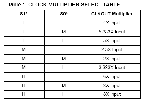

Looking more closely, I see the NB3N511 expects a crystal in the range of 5 − 32 MHz, meaning you can't simply attach a 3.579MHz crystal. But attaching a 3.579MHz oscillator is alright. The input Clock Frequency Range is 1 − 50 MHz.
The NB3N511 is capable of nine different ratios, as shown.
Using the product search may uncover other options. It's actually the product search I intended to recommend, more so than any specific chip.
Ceramic, definitely!
It could be a one-chip solution if there were such a thing as a quad XNOR with Schmitt-trigger inputs. I originally drew it up with XNOR, and then found out it doesn't exist.
