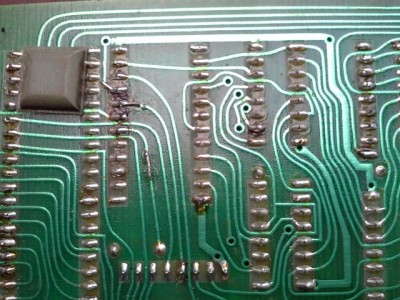

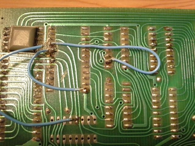

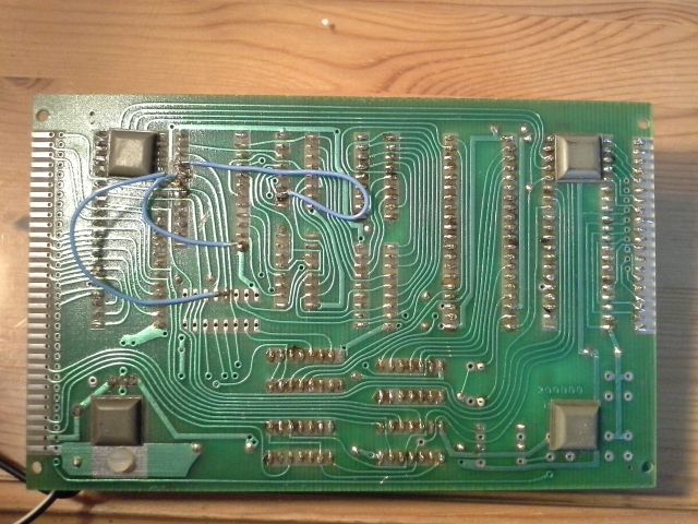

A chance comment I made to an article over at Hacker News led to me being offered a non-working Acorn System 1 for spares or repair for the cost of a donation to charity. Well, it arrived yesterday and it's in pretty good shape. The main board has some logic chips missing and the memory addressing has been hardwired rather than using the address configuration header socket, which has not been fitted. The spectra strip for the display has been repaired in the past and a second wire is broken, but that's an easy fix.
Getting the system going should be fairly straightforward, but the big question is: Do I get it going 'as is', or repair the cut tracks and fit the address select header as per the design spec. I'm tempted to do the latter so that I can use the system as a reference for my planned build of a replica because this will allow me to test the firmware in an EPROM as well as in PROM.
Any thoughts?

...but the big question is: Do I get it going 'as is', or repair the cut tracks and fit the address select header as per the design spec.
If it were me, I'd attempt to restore it to the original circuitry.
Do you know which chips are missing?

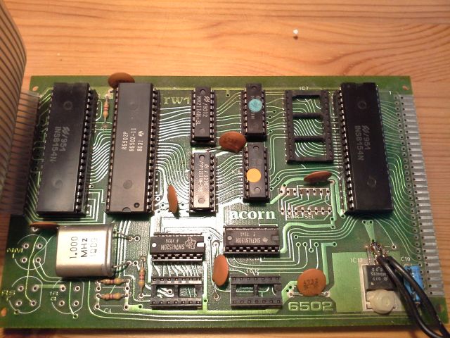

Yes, I have all the schematics and the tech/user manuals - it's a 74LS04 and an LS00 and I have some of those.
As well as the overall restore, I am debating whether to repair the spectrastrip to the display (quick and easy) or replace it (minor hassle, but where to get a small bit?).

  • Previous rework removed and the cut tracks repaired - pic below.
  • Three broken wires on the display Spectrastrip repaired - one was a hairline break that I only found out when I powered up for the first time and noticed a display digit wasn't working.
  • Turned-pin IC socket fitted in address select position.
  • Another turned-pin socket fitted into the first, and address jumper wires soldered to match the original docs. This allows me to rewire the address select later without messing up the base socket.
  • Touched up a few dry-looking joints.
  • IC10 refitted = 74LS04
  • IC12 refitted = 74LS00
  • All existing socketed ICs lifted and reseated to clear any corroded or loose connections.
Having done all the above, I slowly wound up my bench PSU to 7V (allowing 2V drop-out for the LM340-T5 regulator) while monitoring the output from the on-board 5V regulator and the current draw from the PSU - all looked good so I hit the reset button and - YAY LIFE!!!
As could be expected, the keyboard keys need a little exercise to get them working reliably, but I entered a sample program and hit (r)un and saw the expected result. Stepping through the monitor ROM memory shows the expected hex values so that's a good day's work.
