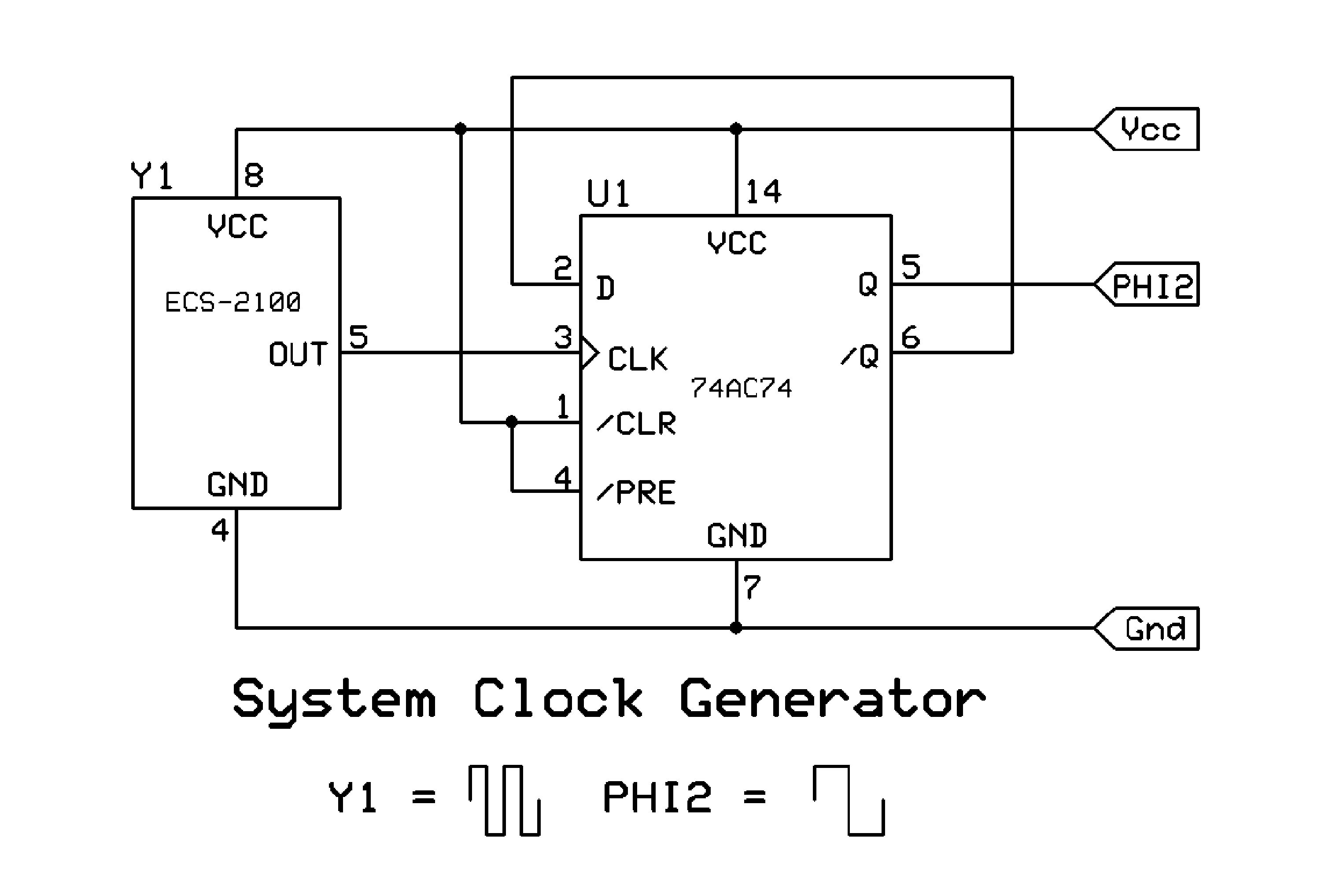

cbmeeks wrote:
Is it advisable to simply plug in a 1 MHz crystal oscillator (can) directly into the CPU? On my oscilloscope the signal appears pretty "square". Or would it be better to run it through some inverters to square it out a little more?
Most of these can oscillators produce ample drive strength and a clean output. For hobby usage at moderate Ø2 frequencies (10 MHz and under) directly driving the MPU (and 65Cxx I/O if used) from the can is fine. My recommendation is once you cross that 10 MHz threshold you should run the can's output through a flip-flop (e.g., 74AC74 or 74AHC74) to sharpen the waveform and assure true 50:50 symmetry. Naturally, the oscillator's frequency in such a setup would be twice the desired Ø2 frequency. You should do your best to keep the signal path from the Ø2 generator to the Ø2 input on the MPU as short and direct as possible.

As Ed noted, scope bandwidth limitations may be why this is happening. A rule of thumb is that the scope's bandwidth should be at least 10 times that of the frequency being sampled in order to see a reasonable representation of a square wave. Your probe will also have an effect. The probe should be operated in the ×10 mode to reduce capacitive loading on the circuit and the scope's ground connection to the circuit under test should be through the ground pigtail on the probe.
The quality of the probe is also a significant factor. There is no such a thing as a good, cheap oscilloscope probe.

cbmeeks wrote:
So, you're saying that I would really need a 140 MHz or higher scope to *truly* see how that 14 MHz crystal looks? I've read that before...where newbies like me get confused on how scopes work with higher frequencies. So much to learn.
Correct on the 140 MHz scope.
When I started out with my 65C816 endeavors, I had an ancient Beckman dual channel scope (c. 1972) with a 20 MHz bandwidth. The 12.5 MHz Ø2 clock on my POC unit looked like a sine wave on it and that was with a good probe. Eventually the Beckman died of old age and I replaced it with a refurbished H-P scope rated for 275 MHz, along with a suitable set of probes. Now the 12.5 MHz clock looks like a square wave and the IRQ line pulses look like pulses.
Incidentally, here is the Ø2 clock generator circuit I use.

So if the X-axis scale of the waveform diagram were microseconds, it would be a 1MHz fundamental frequency. A square wave (with 50% duty cycle) has odd harmonics. There are no even harmonics unless the duty cycle strays from 50%. They show it with just the fundamental, then add the 3rd harmonic (3MHz), then add the 5th (5MHz), the 7th, 9th, 11th, etc.. You can see that by the time it gets to the 9th and 11th harmonics (9MHz and 11MHz), it's looking pretty square. It wouldn't look quite as good if those were down 3dB and their phase were lagging as would be the case with a 10MHz 'scope, but not too bad.
As has already been mentioned, note that even a good probe in the x1 position is only good for a couple of MHz. You must use the x10 position to get the probe's rated frequency. The frequency rating on an oscilloscope is not an absolute cutoff. It's usually the frequency where the response is down 3dB; so there will be very little difference between a 100MHz 'scope and a 140MHz 'scope in that respect. A given harmonic, say the 9th or 11th harmonic of 14MHz, ie, 126MHz or 154MHz, will be there on both, but will be slightly more attenuated on the 100MHz 'scope than it will be on the 140MHz one, and not ideal on either one, but mostly adequate for the job. When I put 70MHz square wave on one of my 20MHz analog 'scopes, it shows a small sine wave, quite attenuated.
As for using a flip-flop to divide the clock frequency by two to get a 50% duty cycle: Having the duty cycle off a bit (say 60/40 which is often the worst-case spec on oscillator cans) is perfectly fine if you're not pushing the speed limits of the parts. Jeff Laughton's animated timing illustrations that BDD mentioned are at http://laughtonelectronics.com/Arcana/V ... iming.html .
