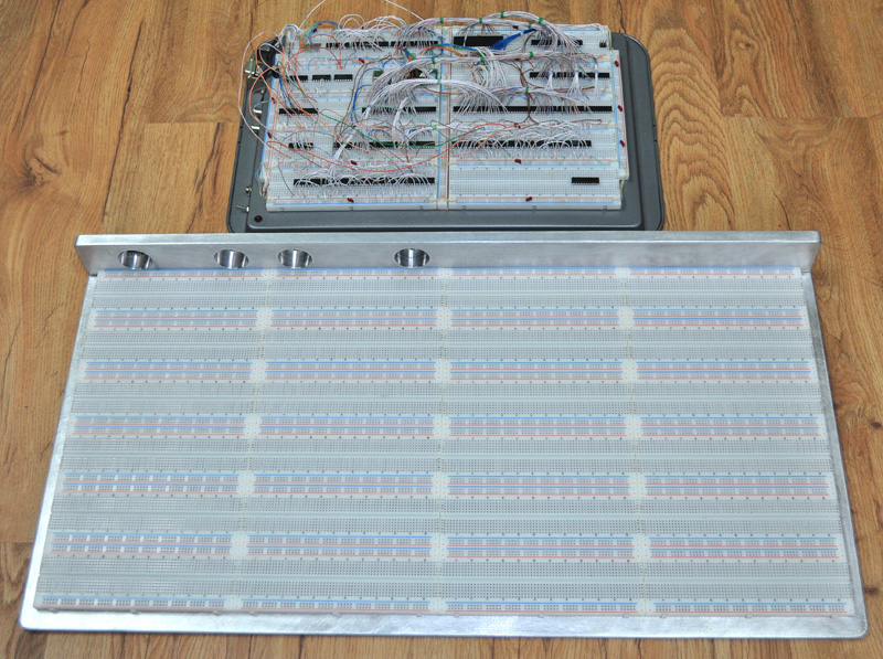

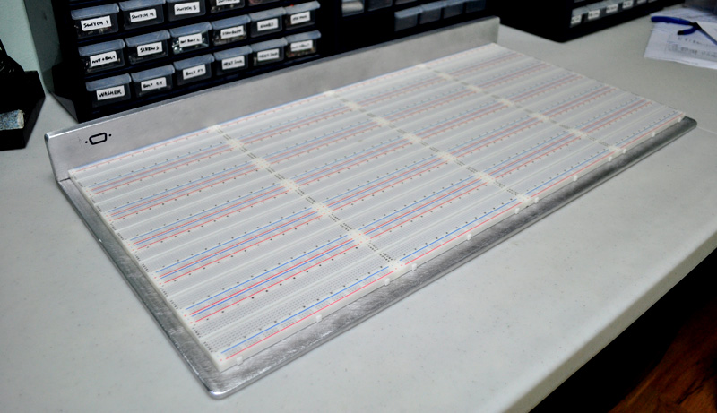

Here is the "Mother of all Breadboards", where my project will become self aware...
Oh, and the reason for the name is because of the pure 74xx based hardware. Logical, Captain?

- The project must first prove itself on a breadboad. From there it will be hand wired onto perforated board. With an estimated chip count of 200, and a speed of 20MHz, I know this will be fun!
If using the large array of solderless breadboards shown, you will probably have to go considerably slower to get it to work. 5ns and faster rise and fall times are not simply DC being switched quickly. Make sure you see our sticky topic here, "Techniques for reliable high-speed digital circuits," and my page "Construction: Avoiding AC-Performance Problems" which is chapter 9 of the 6502 primer section of my website.

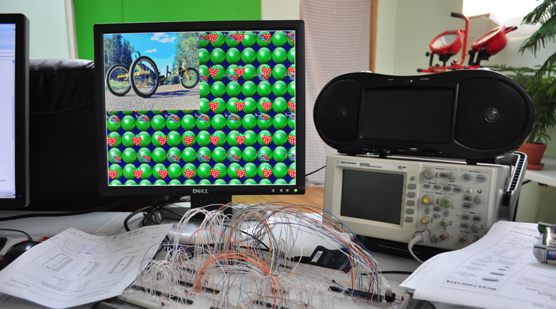

I will admit to being a cycle counting, propagation fanatic! I count every single cycle in all of my projects and work out propagation as if my life depended on it. In my initial testing, I strapped a 10ns SRAM to a 65C02, and then force fed the RAM with an AVR. My decoding path was only 12ns worst case, and I was actually running the 6502 at 25 MHz, clocked from a crude 640x480 VGA circuit I slapped down on breadboard...
Running a 65C02 at 25.175Mhz with no issues!
640x480 image drawn by the 6502 by hurling bytes from an SRAM!
That entire scrambled mess runs at 25.175MHz, with all propagation accounted for using 74HC574s to register bytes whenever a path exceeded 40ns.
This made for some interesting tracking of VGA timing to keep it perfect, but it worked great, keeping to the 640x480 standard exactly.

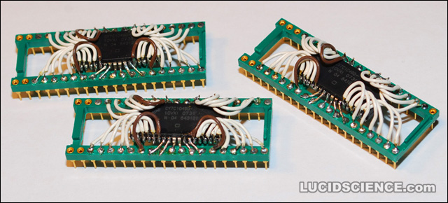

Part of what I mean is the longer wires of the bigger layout will have more ringing and more unwanted coupling between wires. They become like antennas, spring reverbs, and other things that could prevent operation. This is entirely separate from the matter of propagation delays.
For SOJs and SOICs, you can use the adapters made for the purpose, like this one whose image I grabbed from Jameco's site:
They're a lot more expensive than the ICs that usually go on them, but it's worth it when you consider the amount of work they save you.

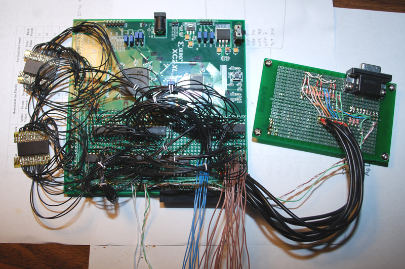

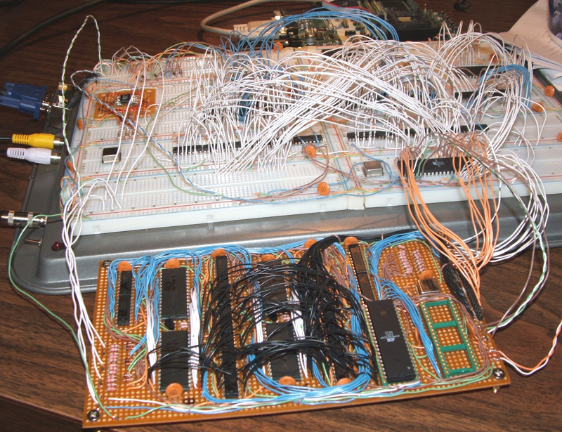

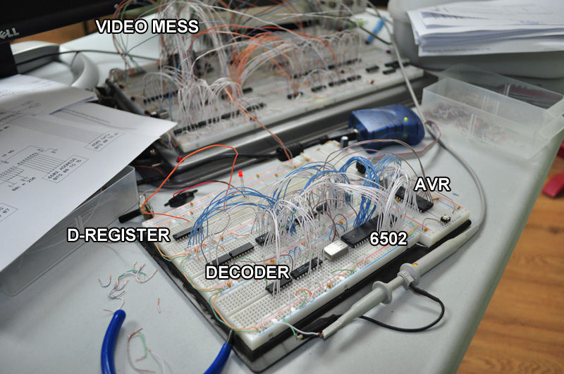

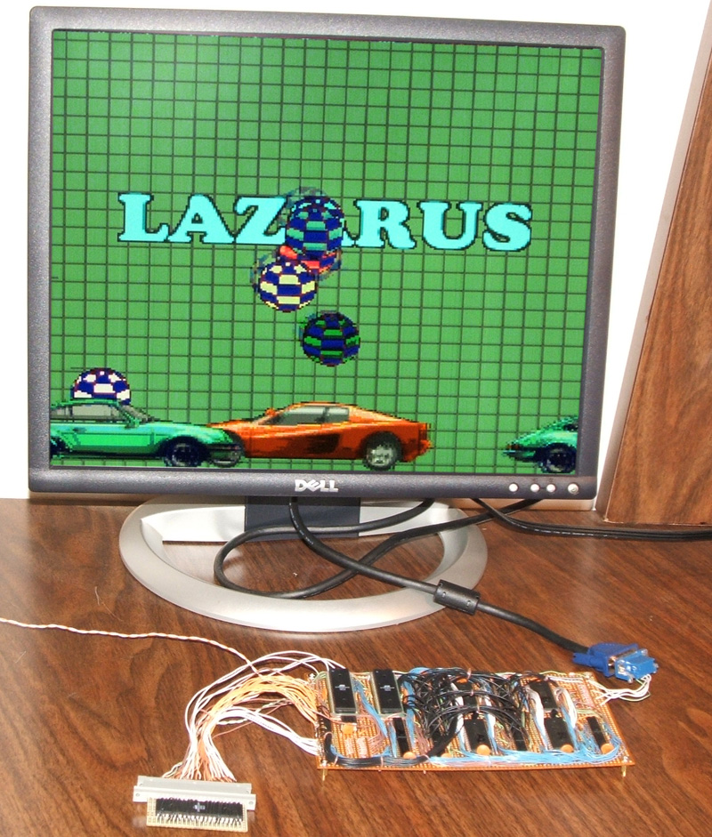

Here are just a few of my mid to large sized breadboard projects that certainly should NOT work due to all of the aforementioned issues.
For the record, I do not tolerate glitches or odd crashing, if a project does not work 100% as expected, it is scrapped.
VGA is particularly intolerant of timing issues. 1 missing cycle out of 420,000, and you get nothing on a modern LCD.
25.175MHz - A 256x240 VGA game system using logic and an AVR.
This one from 2001, only ran at 25.175MHz, due to the use of slow 55ns SRAM I had laying around.
I initially did it on a breadboard, and then hand wired it on perf. board by soldering wires from point to point!
AVR is external to the system, acting as a cartridge. AVR overclocked to 25.175 MHz as well.
25.175MHz - Generating glitch free animation at 60 FPS.
This project was a good learning experience into how critical every cycle is when doing VGA.
On an old CRT VGA monitor, you can get away with anything. Not on an LCD!

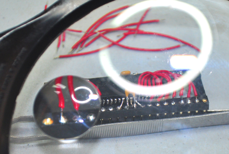

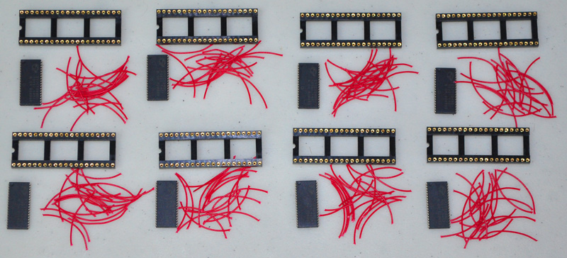

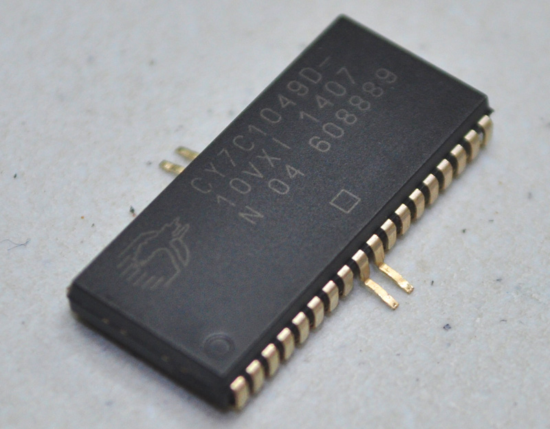

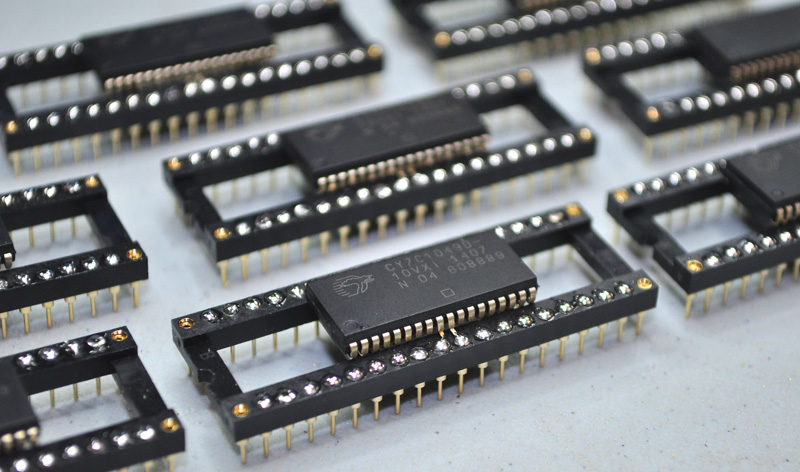

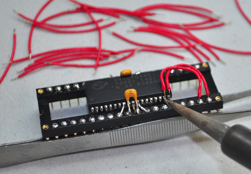

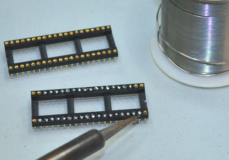

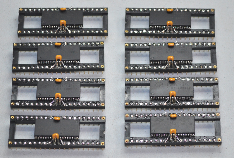

Had some time today, so I soldered the SRAMs to the sockets.
So far, I plan to use the 512K SRAMs as follows...
512K #1 = Front / Back Video buffer (120K used)
512K #2 = Front / Back Video buffer (120K used)
512K #3&4 = 1024K Graphics memory dedicated to GPU block copier
512K #5&6 = 1024K Sample memory dedicated to sound system
512K #7 = Multiplication and Division lookup tables for dedicated ALU
Not sure what to do with SRAM #8 yet, but no doubt it will find a home.
Hope everyone likes photos, I take a lot!

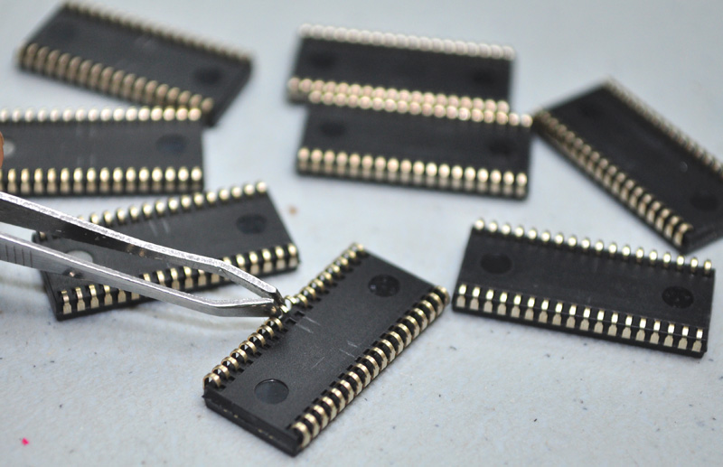

SRAMs, sockets, and a bunch of wires.
Bending the GND and VCC pins for direct connection.
Ready for mounting to the sockets.
Solder balls to accept the wires.
SRAMs mounted to the sockets by 4 bent pins.
Decoupling caps added for good measure.
Adding wires to the pins and socket.
Quality control using a magnifier.
One SRAM done, only 7 more to go!
4 Megs of 10ns SRAM ready for the breadboard!
Ok, that's it for now. I only do this on rainy days, so not sure when the next post is coming.
Will be adding ports to the monster breadboard next and then the layout of chips shall begin!
Besides the SRAM and 65C02, every other IC will only be 74HC logic.
Going to be fun to see how far this can go!
Radical Brad

Just need to tie all the VCC and GND connections on the breadboard strips together and then a duplicate video system will be layed out on the new board.
I will have to take my time and make an actual schematic in case anyone else out there is crazy enough to want to build such a thing.
For the most part, I just winged this all together based on ideas that caused many nights of insomnia.
Never though that my old "Cookie Sheet BreadBoard" would look small!...
I still may run out of real estate after the GPU and sound system are also included. The smaller breadboard contains only the basic 400x300 VGA dual buffer system and an AVR/6502 image loader.
The GPU logic will probably have more chips, and I know the 4 channel digital sound system will have at least 70 chips.

It is I, too praise.
This is an example of animation on the hardware c64 (1 MHz).
I added only 16 MB of RAM (Years 90 ') on the SIMM72 and control for systems 74HC .LS, HCT :)
https://www.youtube.com/watch?v=yxZ7Idi2Bi4&feature=youtu.be

I was wondering how you managed to go for 10ns SRAMs as the best I could find is 15ns Cypress CY7C199CN in DIP. I like your solution, although it looks a bit fiddly/time consuming!
PostPosted: Tue Jun 16, 2015 9:12 pm
He has the Cypress CY7C1049D which I use in the hobbyist-friendly 4Mx8 10ns 5V SRAM modules I make and sell. I know I've seen 8ns and 6ns SRAMs in lower densities.
but my downfall isn't my lack of understanding of ringing, ground bounce, propagation, cross-talk, and capacitance. My downfall has been overwhelming success!!
You forgot inductance which is a big killer. If your new project covers the whole set of breadboards pictured, your wires will be twice as long as the cookie-sheet set. Running something like SPI or even memory at 25 or 57 or 80MHz is not like trying to run a 6502 at those speeds. I want you to be successful, and I want to spare you the frustration I think you'll have with the current plan. I think you're much more likely to be successful if you use wire-wrap and get the whole thing in a more compact layout, and use perfboard with a ground plane and solder each ground pin directly to the plane around it and put a bypass capacitor from each Vcc pin to the ground plane around it. The bigger the layout, the more important this becomes. Regardless, the most important part to keep clean is the clock distribution system. We had another member a few years ago who ran into clock problems with his '816 computer built on a breadboard layout that was much smaller than yours. It will also help to keep the processor's own buses in close, and not run them all over the layout, if it's possible to interface the farther stuff through I/O instead.
