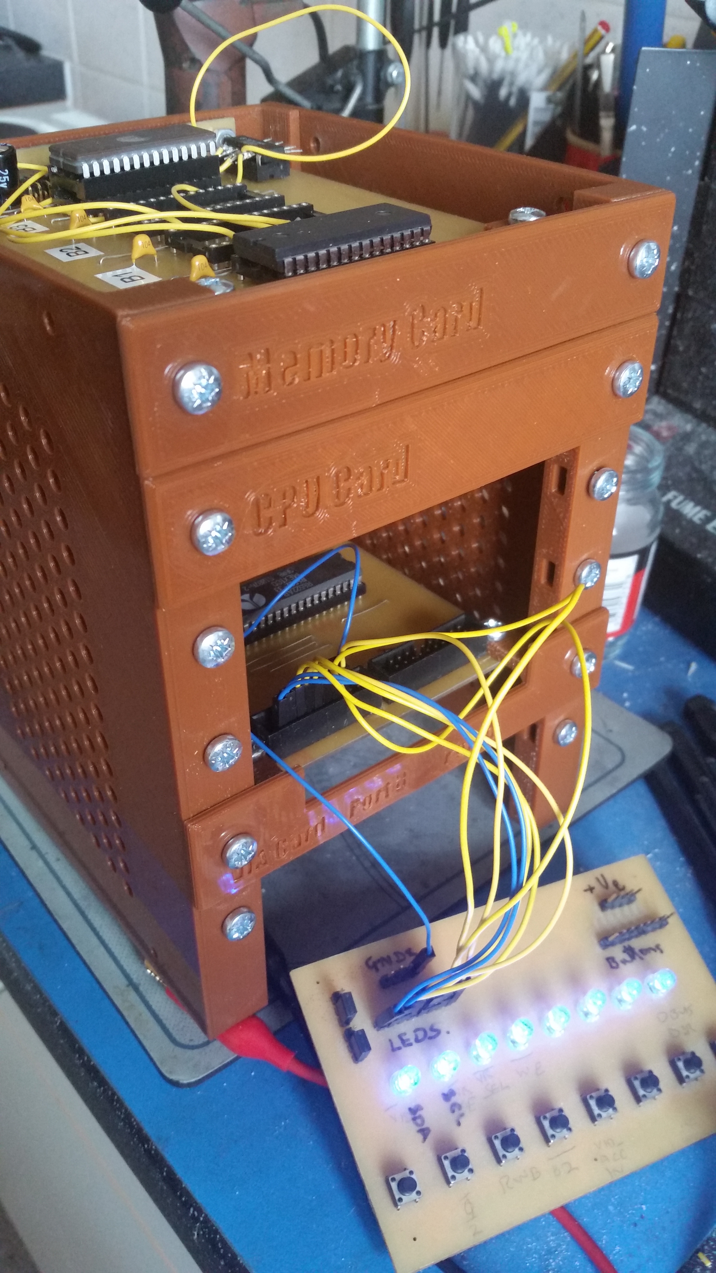

I've never actually built a full video generator before though I did write some Verilog to generate synch pulses and pixel clock a few years ago. There's a start. I've been building electronic doodads and thingummyjigs since I was small ( about 7 ). However I've no formal training. I intend to post pictures when I figure out how to post them in this forum.
PostPosted: Mon May 25, 2015 4:30 pm
Joined: Mon May 25, 2015 1:12 pm
Posts: 92
Hmmm (scratches head), let me see if this works....[img]20150525_143058.jpg[/img]
Ok if this worked then my first ever attempt at a computer (part built) should show up, if not then cue face palm.
PostPosted: Mon May 25, 2015 4:32 pm
OK, great! -- in fact, people that "just grew up building stuff" are often highly talented, IMO.
If you've tangled with Sync pulses then you have some idea how fussy the timing requirements for video are. The other big challenge is generating the sequential addresses, and arranging that they (as well as CPU addresses) can drive the address inputs of the RAM.
When you post your images, be aware you can attach them to your post. IOW, it's unnecessary (actually undesirable) to host them on a third-party server. [Edit: ok, you're one step ahead of me! :) ]
PostPosted: Mon May 25, 2015 5:29 pm
Posts: 10961
Nice looking computer Digitaldunc! Welcome.

One thing I should have done is give my little tower of eightness a name.
Oh and I've been drawing inspiration from the Acorn Electron, Oric 1 and now very recently the Apple II.
