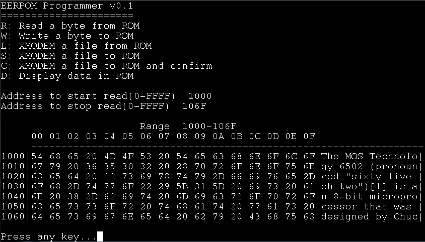

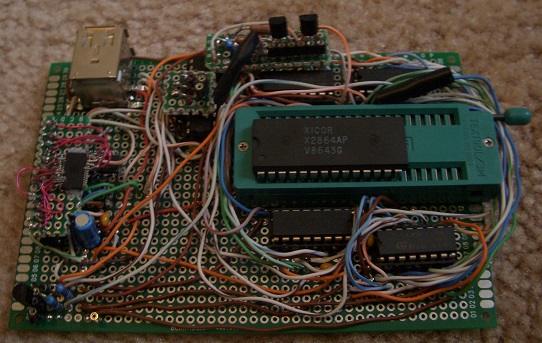

Neat projects! I have been working on my own programmer too and thought I would share. It uses an FT232 for USB communication. I decided to do everything over a serial terminal with XMODEM so it would be compatible with any OS, but using Java for a GUI seems like it accomplishes the same thing. For shift registers I'm using 74HC595s and a 74HC165 all running at 5v with a few transistors to level shift for my MSP430 microcontroller running at 3.3v.

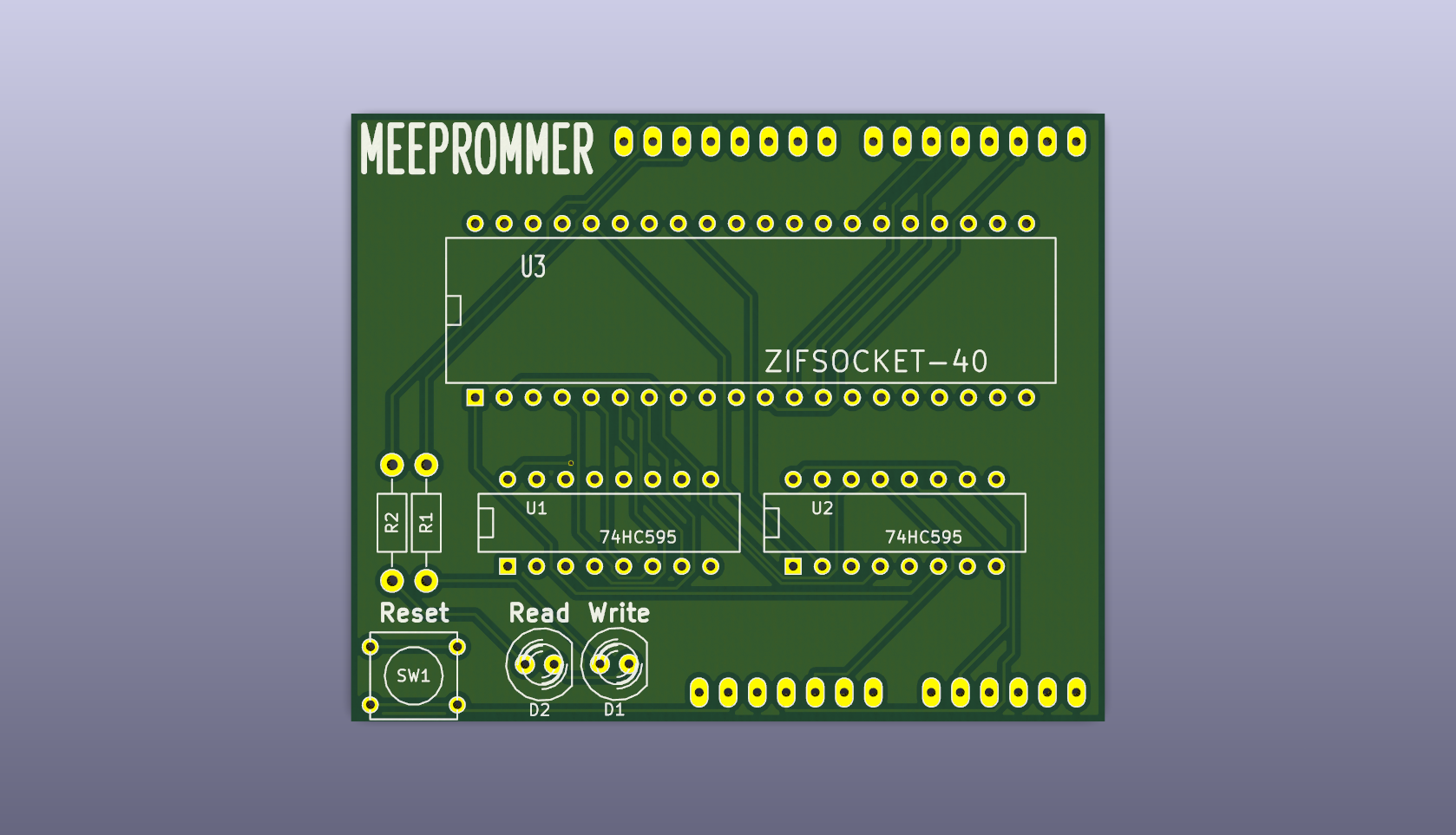

I was working on transferring my breadboard design to perfboard and got really annoyed at trying to cut and place all the many address and data lines - it was a huge hassle. So since I have given up on that route I have started looking at PCB options as all the wiring can be done by the factory :)
I did not use Uniclocker's V2 shield as not all the caps and parts were labeled and I don't need the charge pump circuitry as I am just interested in the 28C chips. I probably could have modified his V1 shield to support a larger zif socket but I decided to take the challenge and learn how to make my own pcb for the fun of it.
I used kicad since it's free and you don't have to deal with some of the free eagle restrictions or trials. It's a simple design with just the ZIF socket (up to 40 pins) and two 74HC595 shift registers required (like many other designs here). I also added a reset button which could help with programming, and two led's for read/write to make sure the board works (although they are not needed for operation). I did not bother with decoupling caps as they increase the part count and price, and the breadboard and v1 designs appeared to function fine without them.
I am probably going to send the design off to be produced soon. If anyone is interested I would love to sell the extras to people here to help spread out the cost. $30 to 3 people is a better deal for everyone then $30 for one person who then has extra boards he does not need. Regardless I will still put up the pcb design, including all footprints, to my github page along with the modified python software I was using so future people may use it if they desire.
"Appeared to function fine" is not quite the same as "functions fine." :) Omitting the decoupling capacitors is a false economy, in my opinion. The require capacitors are very inexpensive and take up little space.
This is true. To be completely honest I don't really know enough about decoupling caps besides that you put them between the power and ground lines near a chip. Not sure what values or types work best.
One issue is that using a 40 pin zif socket takes up a large amount of space. As long as I keep the board the same footprint as an arduino uno I don't have much extra space to place caps near the IC's. Also, the power and ground lines are on opposite corners which might necessitate adding more vias to get everything to connect together. Can I get away with just using one cap around the main vcc/gnd rails, or do I have to add a cap for each IC.
I don't think it is a huge deal but I would fix it if its not too much work. I am always up for more revisions, and as I said I will publish everything so someone else could add it themselves if they desire.

I have a page on avoiding AC-performance problems (which bypass capacitors play into) at http://wilsonminesco.com/6502primer/construction.html, which also includes links to relevant forum topics and ap. notes.
You might be able to put a capacitor on the other side of the board, under the IC. If it's assembled by hand anyway, it's not like you have to worry about extra steps added to production units where you're trying to make money, not lose money, on hundreds or thousands of units.
For any computer board that you want to run at more than a few MHz, you should have one at every IC, with the shortest possible connection length from the capacitor to the IC's power and ground pins, because of inductance. If you had a real ground plane (unlike what's in your picture above), the bypass capacitor should be as close as possible to the Vcc pin, and have the shortest possible connection to the ground plane. However: an EEPROM programmer won't be running very fast, and there should be plenty of time for ringing to die out before the next significant signal transition, right? I really don't think you have anything at all to worry about in that area for the EEPROM programmer. That's why the solderless plug-in breadboard worked. This type of breadboards is great for low-speed analog stuff, but offers the worst of all worlds for fast digital.
