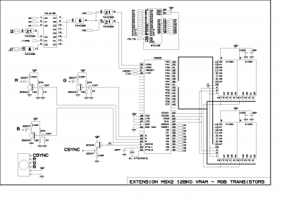

hi guys
i am playing with so pretty old hardware stuff and i wander if anyone has already realized a PCB with a V9958 on it, plus DRAM and the proper interface an RGB-S device
also, i am looking for any examples about the sw side

You can have a look at the MSX machines with a V9958.
Like the turbo-R. Circuit is in the service manual on http://msx.hansotten.com

After Aslak3 successfully made an interface for the V9958 to his 6809 SBC, I made my own for the 65xxx CPU and modified the RGB output to get a better picture.
Furthermore I took the output drivers from a schematic which HansO provided.
(see attachment)
So credit goes to Aslak3 and HansO.

The picture is stable and sharp. Picture quality depends very much on a clean power supply provided for the VDP.

Posts: 62
about the VDU, i see you have {R,G,B,H_sync,C_sync}
C_sync stands for "Composite SYNC output", so the VDU is RGB-S compatible
wandering what is H_sync useful for …
umm, it seems TMS9918/28/29 doesn't do RGB-S
the V9958 there is no separate Vsync output, V9958 does RGB-S, so it output Csync only.
and reading its data sheet of V9958, the Hsync is the horisontal part of the Csync signal.
So the Csync contains both Hsync and Vsync, but how are they mixed ?
a few hypothesis:
  • Csync = Hsync AND Vsync
  • Csync = Hsync XOR Vsync
  • Csync = Hsync -?- Vsync

Location: The Netherlands
I think you can use an LM 1881 Video Sync Separator to separates Csync into Hsync and Vsync.
http://www.ti.com/lit/ds/symlink/lm1881.pdf
Why, do you want to connect it to a VGA monitor? If so, the VGA monitor has accept 31kHz, and as far as I know, only old MultySync monitors can do that.

the story goes more complex :D
i have also been designing a VDU in vhdl, i have realized something (a few vhdl lines of code for a very simple bitmap frame buffer) that works for a VGA lcd, so i am using H and V sync, as they are described in the VGA documentation.
For the V9958 & my VDU-fpga-project I'd like to use the Sony Playstation LCD, which is RGB-S, so, in order to re-use what i have done for VGA i need to combine my actual H_sync and V_sync into a C_sync in order to inter the PSOne LCD
The PSOne LCD AV-connecotr has these signals
  • video_R
  • video_G
  • video_B
  • video_composite Sync
  • LCD_enable
  • sound_right
  • sound_left
The V9958 could directly connected to the PSOne LCD, more work is required for the VHDL code.
