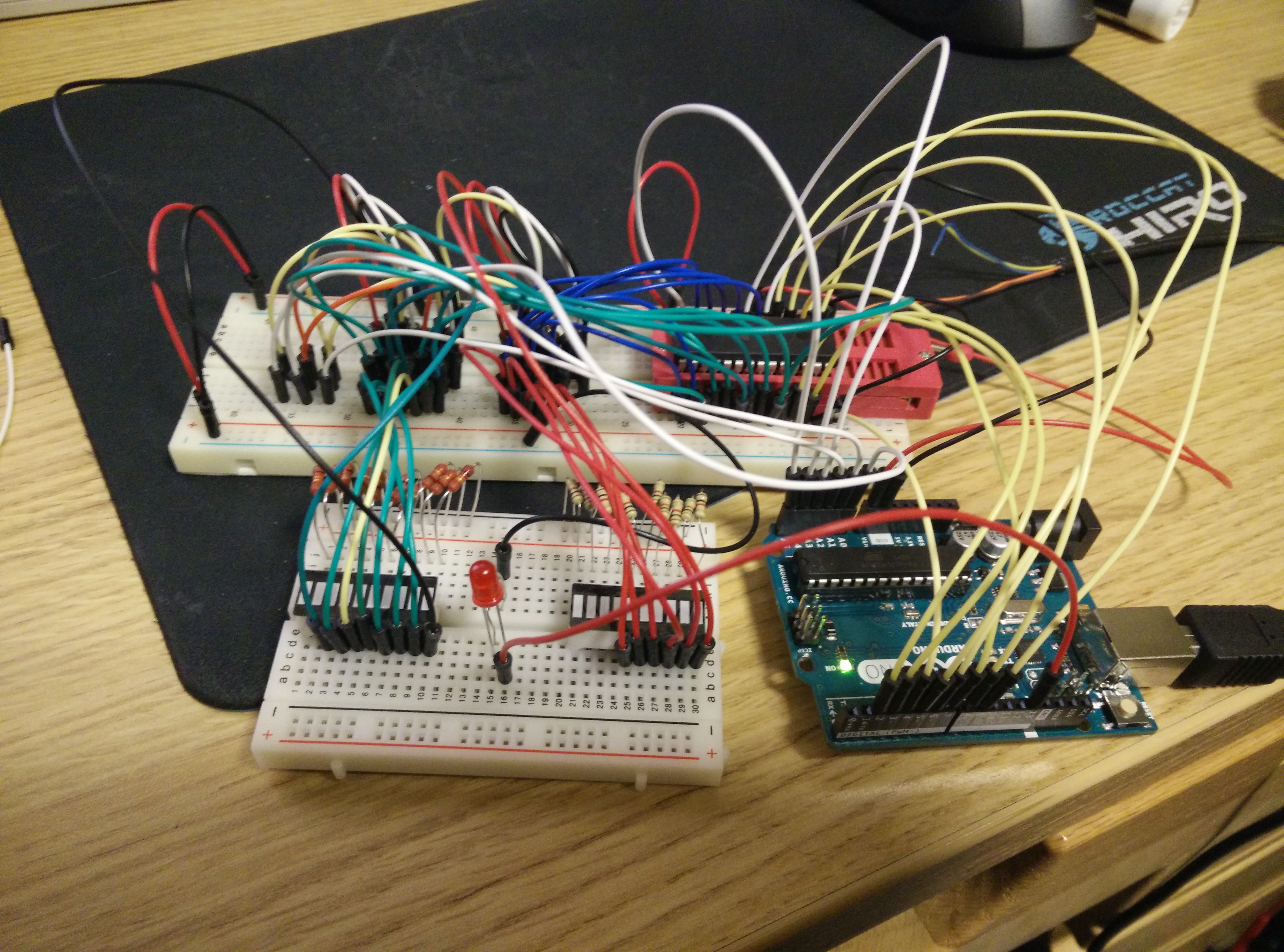

PostPosted: Sat Feb 21, 2015 6:10 am
Joined: Tue Feb 17, 2015 12:36 am
Posts: 7
Location: CA
It works! http://i.imgur.com/yMRQKTD.jpg (I tried embedding the image but it was way too large)
Both the java programs (mkller/rpress) would not compile due to various gui items not existing. Googling wasn't much help. I tried the python program but it had issues saying the ack wasn't received. Playing around in the serial console I figured out that it sent the '%' fine, but the python program didn't recognize it. I guess the library changed and now it returns a byte array so you have to check the first byte not the whole thing. Then the arduino would get stuck in an infinite loop on receiving the data (even though I was sending more than enough bytes). I think it overflowed causing the data to be overwritten/lost before the program could read it, resulting in it not finding enough content. Replaced the loop with a Serial.readBytes and that worked. Then I hooked up some leds to the shift registers and confirmed they incremented correctly after a little fiddling around. Yet it was still not working. I cut up a USB cable, pluged it into a phone charger and used the 5v/ground lines on the bread board with Vin to the arduino (I heard the arduino could sometimes droop the charge over usb) - still no use. Figured out I had my address lines incorrect since the data sheet started at A0, meaning that A14 is a total of 15 lines (not 14 like I originally assumed). Still wasn't working - lifted up the zif and saw I had everything a pin too far to the left. Fixed all that and now it finally works! It's been a long few hours of debugging but I'm glad it works :)
Hopefully seeing all the problems I hit can help anyone else who tries this and has an issue. it's always good to have ideas for where to look. I can upload the shift register test if anyone thinks it would be useful...
Trying to build a z80 HBC.
PostPosted: Sat Feb 21, 2015 8:19 am
Posts: 10938
(Let's test this - I'm pretty sure that if you attach a large image, but choose not to use the 'place inline' feature, it won't supersize itself. It's much better to get the image onto this site, because in the past useful images in posts have disappeared when the image hoster makes changes, or goes bust.)
File comment: testing a non-inline attachment
