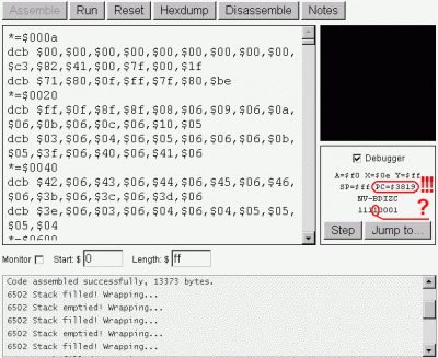

Hi All,
Before testing my own 6502 JS simulator I've observed the Nick's easy6502 simulator
behavior while executing this special version of Functional Test for the NMOS 6502.
And here is the result:
I see that:
                        ; S U C C E S S ************************************************
                                success         ;if you get here everything went well
3819 : 4c1938          >        jmp *           ;test passed, no errors
But I wonder, and I don't understand yet such a thing that in Nick's easy6502 simulator
the B flag is always set! :shock:
I think that
The copy of the status register that is pushed on to the stack will have the B flag set if
a BRK (software interrupt) was the cause of the interrupt
, or cleared if an IRQ was the cause.
In my version the reg P is initiated with $20 value, but in Nick's it starts with reg P = $30...

PostPosted: Sat Dec 27, 2014 10:11 pm
Posts: 442
Location: Wiesbaden, Germany
A few weeks ago I answered almost the same question (viewtopic.php?f=8&t=3111#p35579):
Klaus2m5 wrote:
The emulators just follow the behavior of a real 6502 or any of its hardware successors. The unused bit returns a 1 when read, because it is not present in hardware and reading an open circuit simply returns a logic high state. The same is true for the break bit, as it is not an existing flag bit register but a forced low to an otherwise open circuit. The bit is forced low only when the processor flag bits are pushed onto the stack during either an IRQ or a NMI. So the break bit would be better defined to signal "pushed by software" (BRK or PHP only).
There is also a discussion in this thread about my test expecting these bits to be on after a PHP. viewtopic.php?f=2&t=2241&start=30#p20914
