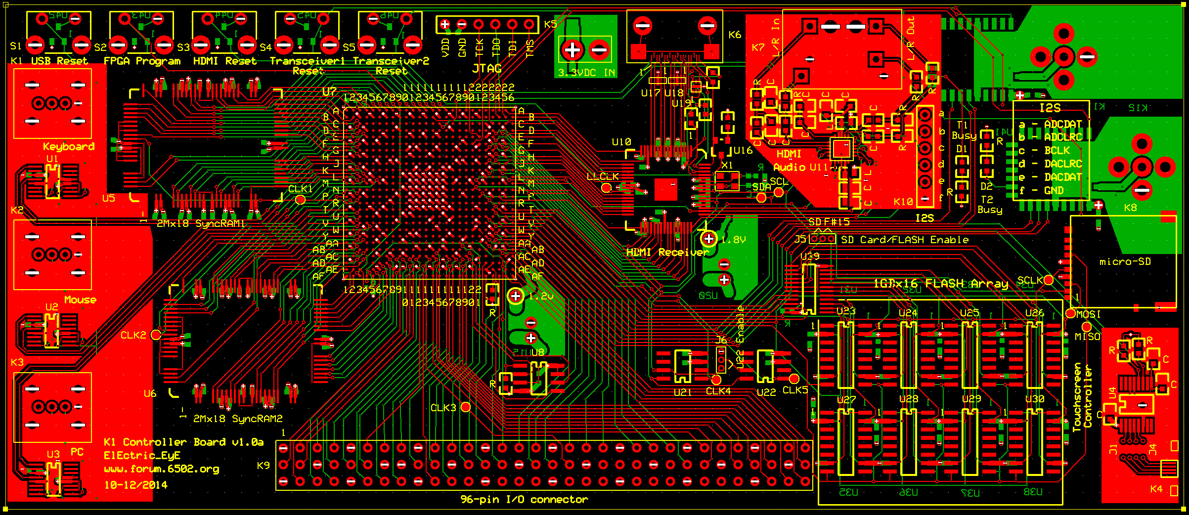

Re: K1 Controller Board with Video Capture
Here is the link to the SSM2604 data sheet, I should've provided it before. It's a 20-pin QFN, everything is serial.
I have to make a state machine in Verilog to create the 16-bit parallel data. Since the 2 serial lines that involve recording, already go to the FPGA from the SSM2604, I have a chance to analyze the data once I get the state machines correct.
What I really wanted to do was to have the capability to output the parallel data along with the clock to an offboard DAC as proof, something I could hear.
Currently, all this K1 controller board can potentially do with this serial data is display it in the graphics, no other output unless I add this connector I mentioned.
EDIT: Then I have another idea for this connector. Since this is a 16-bit parallel interface, I'm looking into the signals necessary for (old school) parallel ATA. This is the beauty of FPGA.

I've rethought this 16-bit I/O interface and decided against it at this time. I already have on-board storage overkill with 1Gx16 SPI FLASH and a micro-SD FLASH adapter. Also, there's no easy way to route more pins out through the XC6SLX25 on a 4-layer board. I probably could...
What I have been focusing on, are the challenges that await me mounting a 676-pin 1-mm BGA IC. I've re-read through one of my favorite threads here on 6502.org: the BGA mount thread. 1 expert suggests stencils and solder paste and reflow oven. Another expert suggests a hotplate and flux.
For me stencils are out of the picture, so is purchasing a re-flow oven. Too much money.
I would like to have 4 more holes drilled into the hotplate I currently own and add 4 additional heater elements in series/parallel combination to the 4 that already exist. Then when mounting the 676-pin BGA, in addition to the hotplate for the heat below, use the hot air from my SMT reflow station for hot air from above.

I've done a 4-page writeup on the intended functions of this board. It's very general, but does give some insight of my expectations of the inner workings. Should be visible on MS Wordpad. I will post the final version of this writeup on the head post.
Very close to a final PCB layout.

I finished my simple little MS Excel parts spreadsheet to auto add/multiply for parts prices (prices x QTY) then add the $ext column for the total...
It's not pretty, I thought there was an error in the addition or something. I mean $514?! I can't afford that for a prototype board. On top of the $320 manufacturing cost for 2 stinking boards. This is close to insanity, IF I were to populate the entire board at once, which would be very foolish... Maximizing a board potential is not so foolish when one is paying for real estate.
If the audio section, RF transceiver section, touchscreen controller sections were left unpopulated, parts cost would be down to $280. This might be manageable... but still $318 board + $280 parts is such a risk for me since I am a novice at BGA mounting. I'm very tempted to start smaller, and design a new PVB around 2 SyncRAMs and a XC6SLX25 1mm 256-pin BGA. I've already started a new thread about this.
I have the SyncRAMs I could salvage from 2 boards, and I have an XC6SLX25 256-pin BGA I bought just so I could see the solderballs. All it would take is a new design and around ~$200 for the boards. This is in the ballpark.
One of the glaring costs is the SPI FLASH I chose. Sh*t, I might as as well look into interfacing to an older SSD, but this requires SATA.
EEyE:
I haven't tried to use the SPI Flash that you selected in one of the multiple IO configurations. However, it is possible to use them in a 2x and 4x mode. I suspect that you could implement a very fast, two bank interface with between one and four of theses devices. You can use the decoder to allow you future access to the other devices on your board after testing your board with one to four devices. That reduction in parts count alone, coupled with a change to a smaller pin-compatible FPGA will provide significant savings.
My recommendation was for you to use the SOL16 package for all of your SPI Flash. The configuration memory device and any user memory devices. To reach the 1Gb density level for your configuration device, you'd need to provide the two chip selects as you're doing for your SPI Flash array. However, I don't think that will be advantageous. At some configuration device density point you'd loose support in the Xilinx tools for the in-system programming of those devices with the Xilinx indirect programmer. However, you'd be able to populate all of your Flash slots with a single inexpensive device type such as you are using for the configuration memory. It also supports the multi-bit interface. Thus, you'd be able to test most of your IP without having to expend big bucks for the prototype, and after that is successful, you can spring for the higher density parts.
MichaelM wrote:
...At some configuration device density point you'd loose support in the Xilinx tools for the in-system programming of those devices with the Xilinx indirect programmer...
I wasn't planning on using Xilinx ISE to program the 1Gx16 SPI FLASH array...
I see now where misunderstanding may have occurred and apologize for the confusion. I forgot to include the 32Mbit SPI FLASH (U8) which is dedicated for the FPGA programming through JTAG, I'll update it soon. The XC6SlX45 676-pin device only needs 16Mbit, but I thought it might be nice to experiment with multi-boot, although I've read in Xilinx forums that they've had issues with multi-boot. Multi-boot is not critical in this case, but nice to maybe experiement with the issues...
The 16Gbx16 FLASH ARRAY is on a separate SPI bus. I will update the 'comments' section of the parts list with the appropriate IC# on the board layout.
