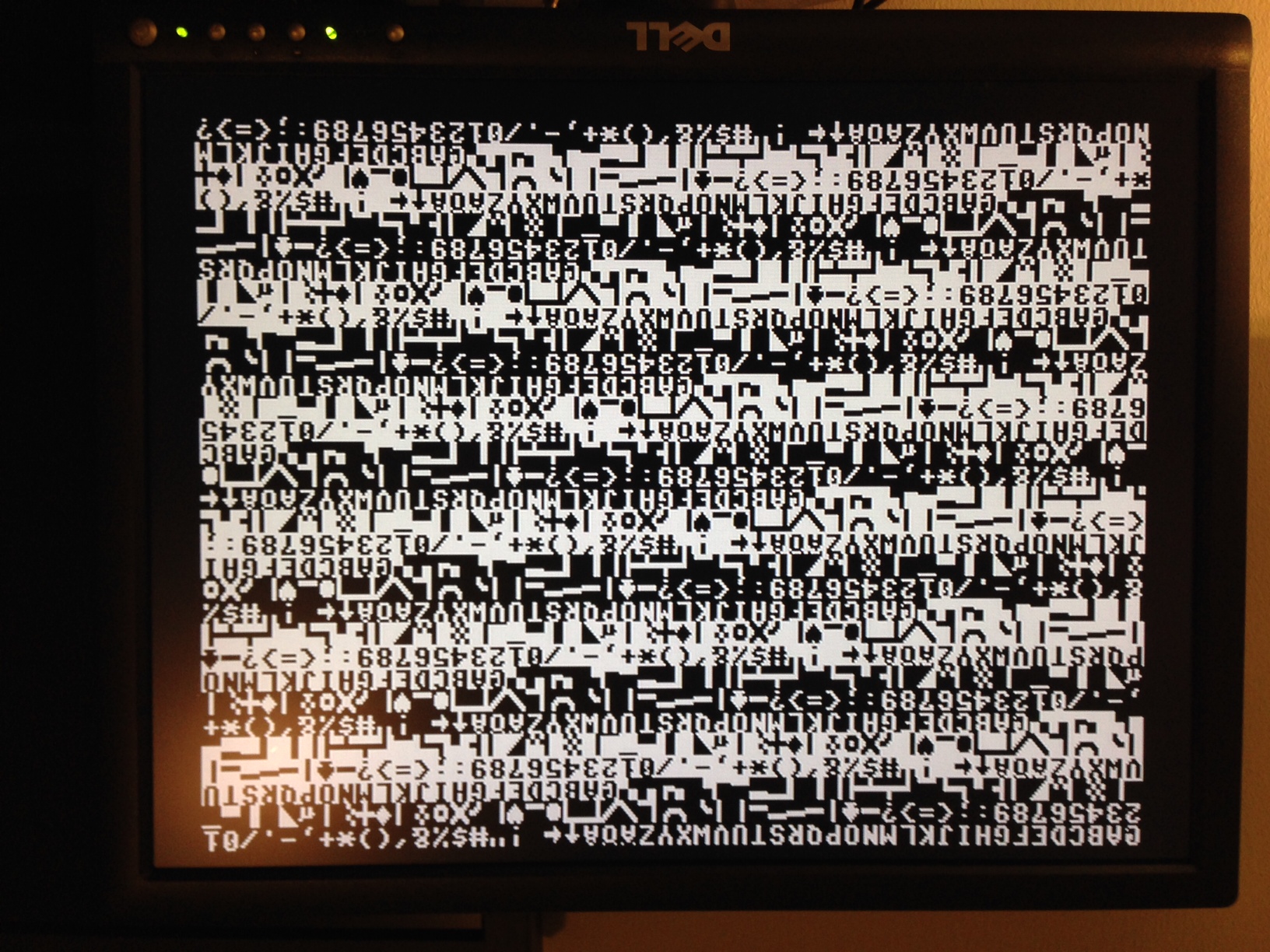

I've been working on bitbanging the video signal for a few nights. This is what I got at the moment:
https://www.dropbox.com/s/2aj7a0j5jyyda ... t.JPG?dl=0
Unfortunately I've hit a major snag. I'm using ATMega's SPI hardware to output the pixels. It's the fastest method to gets bits out of the chip, achieving 8 MHz pixel clock, enough for 320x256, when the chip is clocked at 16 MHz. Unfortunately I've now found out the hard way that the SPI hardware cannot generate a gapless signal. After sending a byte, there is a small gap (1 pixel?) between pixels. This seems to be a AVR hardware limitation and there is no way to workaround this as far as I know..
Close up of the issue:
https://www.dropbox.com/s/0dst7zdmccuuc ... m.JPG?dl=0
It seems I will have to live with the artifact or make some major changes.

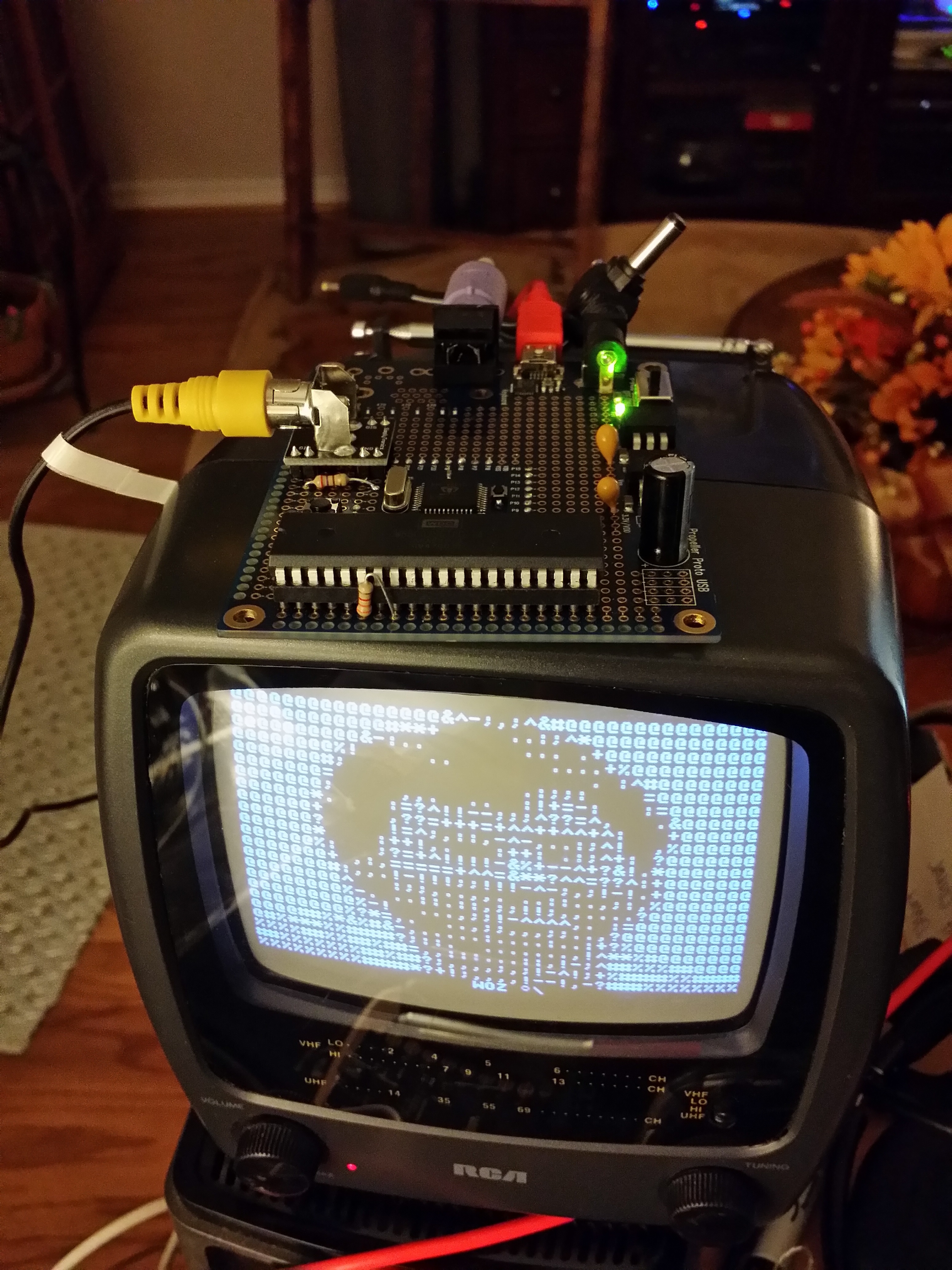

As a short term side project, I'm working on a simplified version of Propeddle called L-Star, which consists only of the Propeller and the 6502 (and some peripheral chips such as the EEPROM and FTDI serial converter and power supply, but no RAM chip, and no glue logic). It's currently only capable of emulating the Apple-1 but it works great. There's no documentation yet but you can find it in my Github in the L-Star repository (no link here for now, because it's under development; you'll find it if you look for it). See the Hardware.spin file to find out how I connected the WDC65C02 to the Propeller, with only the address bus, data bus CLK0 and R/W pins. That leaves 7 pins on the Propeller that are used for a serial port, a PS/2 keyboard, a 1-pin monochrome TV output. The CLK0 pin is shared with the SCL pin on the I2C EEPROM from which the Propeller boots, and the SDA line to that EEPROM has to be kept high to keep the EEPROM from getting confused by the 1MHz clock on SCL. There's not even a pin available for the reset line (though a 1-pin PS/2 keyboard driver exists but I have plans with the "spare" keyboard clock pin), so I use a trick to simulate a RESET with a BRK instruction (which should work in most cases but is not guaranteed).

Have you tried to use one of the USARTs in SPI mode? The USARTs have a buffered transmitter and should be able to generate a seamless bitstream.

I finally found a workaround for the gap between pixels! I can now generate a stable 400x256 signal (50x25 chars).
Full battle report on my blog:
http://petenpaja.blogspot.com/2014/12/e ... ignal.html
I also received my WDC 6502s in the mail from Coltek UK today. So I can upgrade my computer to ran at 8 Mhz and get rid of the address line 74HC541 buffers. 8 Mhz probably does not run robustly on a breadboard tho, but it's nice to have the option when I rebuild this on a PCB.
The nice thing about this design is that the video chip (the ATmega1284P) and the 6502 can run at their own clock rates, as long as the ATmega is able to generate the necessary clock frequency for the 6502.
File comment: 400x256 PAL, black and white for now, bit banged using USART in MSPI mode.
