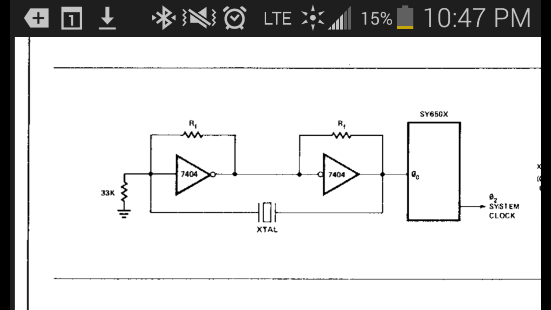

Would adding 2 22pF caps between both pins of the crystal and ground force the clock to oscillate?

See the 6502 primer's page on clock generation, at http://wilsonminesco.com/6502primer/ClkGen.html . There are a couple of ap. notes linked there also on making oscillators. Using oscillator cans however is less work, more reliable, and takes less board space.

I have read both of the pdfs on your primer, and the circuit you have at the top is the one that I am using, I just didn't know if anything is omitted to simplify it. I could do a Colpitts, but I was wanting to try it around the 7404. Just for a learning experience.

In going from 74LS04 to 7404, I think the resistor from the input (on the left) to ground will need to be about a quarter as much, since the 7404's input current is quadruple that of the 74LS04. There is no reason to use 7400 logic anymore though, unless you have a lot of it and you're in a place or situation that makes it hard to get at least 74LS if not 74HC or other CMOS. The capacitors provide phase shift; but for myself, without being strong in oscillator-related math (which can get rather complex for oscillators if you want them to be dependable across the range of all potential operating conditions), I don't know if maybe the 7404/74LS04's inputs provide a heavy enough load to omit the capacitors. I design mostly analog circuits for a living; but although I've designed various kinds of oscillators that do work, I don't consider myself to be expert enough in that department to fully trust my own crystal oscillator designs for products we will be marketing. For that, I'd rather buy an off-the-shelf one.
