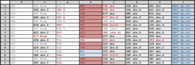

The college football season is almost over, so I've had some time recently to get back to my FORTH VM issue. After some noodling on this problem, I have settled on the approach that I'm going to take. I will add an internal module dedicated to providing internal IP and W registers. Not all of the issues have been resolved, but as Jeff suggested, including the IP and W registers internally will provide the best performance. It may lower the overall clock rate marginally because some of the additional multiplexers required are in the critical address path. However, the savings in terms of clock cycles more than offsets the small additional address path delay they introduce.
On the mapping of the FORTH VM registers onto the registers of the M65C02A, I've made the following decisions:
(1) I've decided that IP and W will be implemented internally as additional 16-bit registers.
(2) The Y register will be augmented with a modulo 64 stack pointer capability and used to implement the return stack. To mechanize these feature, a prefix instruction OSY will be used to override the normal stack pointer S with Y. Thus, everywhere OSY precedes a stack instruction, PHA, PLA, etc., the Y register will be used instead of S. The additional clock cycle penalty imposed by the prefix instruction is not particularly onerous given that the parameter/data stack is much more frequently used. The post-indexed stack relative indirect instructions will be modified to use X instead of Y as the index register. Y was chosen as the RSP because it is not as commonly used as the X register. Keeping Y as part of the stack-relative indexed indirect addressing mode would result in a lot of unnecessary saving and restoring of the RSP. This change uses the X register in a previously unsupported manner, but the stack-relative indexed indirect addressing mode is unique to the M65C02A. Therefore, with no existing tools supporting the mode for 65C02-compatible parts there's no reason not to make the change.
(3) The normal stack pointer S will be used as the PSP.
(4) Neither the A or the X register will serve as dedicated FORTH VM registers. This allows X to be used as it has been in 6502/65C02 programming, and for A to be used in a normal manner.
I've almost worked out how to extend the operation of the ALU to support 16-bit functions. As a consequence, I've defined two prefix instructions, SIZ and ISZ, to define an operation as a 16-bit load, store or ALU operation. SIZ will extend the instruction from 8 to 16 bits. ISZ will extend the instruction from 8 to 16 and also convert the addressing mode to an indirect mode. These two new prefix instructions supplement the IND prefix instruction implemented for the last release of the M65C02A core. Two other prefix instructions, OAX and OAY, allow A to be overridden by X or Y. These two prefix instructions allow the full capabilities of the ALU to be applied to the X and Y registers. An override of this type applied to the S was considered, but the lack of opcode space precluded its incorporation into the plan.
I am a bit partial to the stack-oriented ALU of the Inmos Transputers. I have designed several ALUs for use in my work that utilize that stack architecture. I've decided to at least incorporate a triple level stack in place of the M65C02A's A register. Depending on the effectiveness of that evaluation stack, I may add a triple level stack for X and Y as well. I expect the stack to reduce the number of load and store operations that are needed to perform computations. In support of this anticipated evaluation stack, I've reserved three opcodes DUP, SWP, and ROT to manipulate the evaluation stack. Each LDA will push the stack, and each STA will pop the stack. Arithmetic operations will operate as TOS and memory as currently supported by the 6502/65C02 ISA.
The FORTH VM will be supported by a number of single byte instructions: NXT, ENT, PHI, PLI, INI. NXT will perform the inner interpreter function. ENT will push IP onto the RS (PHI) and set IP as W + 2. ENT followed by NXT will complete the entry of the FORTH VM into the primitive. Exit from a primitive will consist of pulling IP from the RS (PLI) followed by NXT.
When used without the IND prefix, NXT will perform as required for DTC FORTH VM. When preceded by IND, NXT will perform as required for an ITC FORTH VM.
The stack-relative addressing modes should make the implementation of many of the fundamental FORTH functions much easier. Thus, not supporting additional FORTH primitives with dedicated instructions is not required given the expanded instruction set of the M65C02A.
I am interested in any feedback. The following two figures (transposed into the more common format) provides the planned expansion of the M65C02A instruction set to support ITC and DTC FORTH VMs:
Michael A.

It sounds very interesting, Michael, but I'm having some difficulty seeing a clear picture of how your modifications can be used in a programming context.
Would it be possible for you to share some sample code snippets, showing how your new instructions and addressing modes can be used to implement a simple benchmark, like Sieve of Eratosthenes, or some Forth core primitives, like (for example) + - AND ENTER EXIT @ ! DUP SWAP ...
Thanks,
Mike

PostPosted: Fri Nov 21, 2014 2:50 pm
Posts: 760
Location: Huntsville, AL
Ed:
Good point regarding the automatic adjustment of an evaluation stack. Pushing and popping elements from the hidden registers of the evaluation stack should be performed explicitly in order to preserve the expected behavior of the LDA and STA instructions. Therefore, pushing should be performed using the DUP LDA instruction sequence, and popping should be performed using the STA ROT instruction sequence. These two sequences could be wrapped in appropriately named macros to make using the evaluation stack a bit easier. Both DUP and ROT are single byte, single cycle instructions, and when used this way, they will essentially function like some of the prefix instructions.
Mike:
I've read Loeliger's and Brody's books, Brad's tutorials, but that is about as close as I've ever come to FORTH. Perhaps I've missed something obvious, so I'm looking to you, Jeff, and others to clear up any misconceptions that I've had while working to determine the best instructions to design and implement to support a FORTH VM with the M65C02A.
From Brad's website and the Heart of FORTH page, the three core operations of a DTC/ITC FORTH inner interpreter are defined as shown below:
             ITC                                     DTC
NEXT:   W      <= (IP++) -- Ld *Code_Fld     ; W      <= (IP++) -- Ld *Code_Fld
        PC     <= ((W))  -- Jump Dbl Indirect; PC     <= (W)    -- Jump Indirect
ENTER: (RSP--) <= IP     -- Push IP on RS    ;(RSP--) <= IP     -- Push IP on RS
        IP     <= W + 2  -- => Param_Fld     ; IP     <= W + 2  -- => Param_Fld
;NEXT
        PC     <= ((W))  -- Jump Dbl Indirect; PC     <= (W)    -- Jump Dbl Ind
EXIT:
        IP    <= (++RSP) -- Pop IP frm RS    ; IP     <= (++RSP)-- Pop IP frm RS
;NEXT
What I've noticed is that NEXT is the instruction sequence through which both ENTER and EXIT complete. In Loeliger's book, he goes to great pain to terminate ENTER/EXIT through NEXT. In the preceding side-by-side pseudo-code description of these operations, it is clear that the only difference between the ITC NEXT and the DTC NEXT is the double indirection on W to reach the machine code that must be executed. I have reasoned that the M65C02A ENT instruction pushes IP onto the RS (return stack) and advances the W to point to the param field. I am assuming the following FORTH dictionary structure for which the Code Field is a two byte field for both ITC and DTC.
    struct FORTH_word_t {
        uint8_t     Len;
        uint8_t     [Max_Name_Len] Name;
        uint16_t    *Link;
        uint8_t     [2] Code_Fld;
        uint8_t     [Code_Len] Param_Fld;
It is my understanding that the ITC code field points to ENTER if the word is a secondary or it points to NEXT if it is a primitive. In either case the double indirection on the code field locates the correct inner interpreter operation/routine/instruction. In the ITC case, the inner interpreter's NEXT is built from the IND NXT instruction sequence, and NEXT is built from ENT IND NXT.
It is my understanding that the DTC code field contains either CALLs/JMPs to ENTER (secondaries) or into the machine code in the param field (primitives). Thus, the DTC code field is filled with ENT NXT (secondaries) or NXT NOP (primitives).
In either case, EXIT from a primitive can be implemented as OSY PLI NXT or OSY PLI IND NXT (Pull IP from RS followed by NEXT). (The OSY prefix instruction forces the use of Y register instead of S for stack operations. I think that FORTH's EXECUTE needs to be able to pull IP from the parameter/data stack (PS/DS) (where S is the PSP), so I've opted to use the OSY prefix instruction to select the RS instead of the PS/DS.)
I've not implemented the IP/W module, but I expect ENT to be implemented much like a normal 16-bit push instruction with the IP <= W + 2 operation taking place in parallel using a dedicated increment by 2 function within the module. Thus, I expect the cycle count for ENT to come in at 3 cycles. I expect NXT to use 2 cycles for each level indirect operation and to use the same increment by 2 function to adjust IP. Therefore, I expect DTC NEXT (NXT) to come in at 5 cycles and ITC NEXT (IND NXT) to come in at 8 cycles.
The preceding discussion should explain my thinking on the FORTH VM inner interpreter support instructions: NXT, ENT, PLI. Any comments or corrections of misconceptions on my part are welcome.
From my work with Transputers and my stack machines, I think that many of the parameter stack operations can be performed more efficiently using the stack relative addressing modes. I realized that I had declared to new instructions INW dp and DEW dp. With the SIZ prefix implemented by the ALU and microprogram, there is no need for these two instructions. I think that I will re-purpose them as instructions for adjusting S. In other words, INW dp may be better used as ASP #imm (Add #imm to S) and DEW dp may be better used as SSP #imm (Subtract #imm from S).
As I understand FORTH @ it is used to read a memory location whose address is the pointer in the TOS element of the PS/DS. Also the pointer is removed from the PS/DS and the value read is pushed onto the PS/DS. Using stack relative addressing, FORTH @ can be implemented as follows:
    SIZ LDA (0,S)
    SIZ STA 0,S
As I understand FORTH ! it is used to write a memory location whose address is the pointer in the TOS element of the PS/DS with the data taken from the NOS element. Also both the pointer and data are removed from the PS/DS. Using the SIZ prefix instruction, FORTH ! can be implemented as follows:
    SIZ PLX         ; Pull pointer from PS/DS
    SIZ STX dp      ; Store into zero page pointer location
    SIZ PLA         ; Pull data from PS/DS
    SIZ STA (dp)    ; Store data using zero page pointer
I will provide some additional code fragments later today, but I've got head off to work now. :) :( take your pick.
I'm not 100% clear on the modulo 64 part, but I certainly endorse having a prefix to allow stack operations via a register other than S. But do circumstances force you to use Y? Would it be possible to create a new register instead? That would allow you to avoid the (to me) unsettling changes in the usage for Y.
I recently read somewhere, I'm thinking on the Heart of Forth website, that the FORTH standards recommend/require a minimum of 32 cells (64 bytes) on the return stack and 64 cells (128 bytes) on the parameter stack. Given that the RS would be allocated in zero page, I reasoned that making the stack mechanism perform in a modular manner similar to the system/parameter stack would be beneficial. Such behavior will tend to protect the zero page memory not allocated to the return stack. Thus, I decided that the least significant 6 bits of Y would increment in a modulo 64 fashion. The upper two bits would be available to define which of the 4 64 byte pages in zero page are allocated to the return stack.
- are there instructions you added very early in the project whose function is now largely supplanted by the cool new prefixes?
With regards to this, I've moved to redefine two of those instructions, and they are to be used for adjusting the system stack pointer (S). There are of course the bit-oriented Rockwell instructions. Redefining them remains an option, but not if the M65C02A is to be instruction set compatible with the existing W65C02S microprocessor. I've included all four of the Rockwell instructions (32 opcodes) as well as WAI and STP. Since I made the Rockwell instructions support the IND prefix, there are actually eight instructions now supporting two addressing modes: zp direct and zero page indirect. I think that the new addressing mode will make these instructions much more useful. Also, keep in mind that I'm trying to keep the M65C02A as standard as possible in order to make use of available tools such as assemblers, compilers, and interpreters. Access to the features enabled by the prefix instructions will likely lag until someone (probably not me) adds the new instructions to a tool.
- have you wrung all possible functionality from the prefixes?
The quick answer I'm sure is no. I've considered doing what you point out below, but I will defer that until after the new definition is implemented and released.
One remedy for that is to allow a prefix to have one meaning in regard to one group of target instructions, but a different meaning when applied to a different group of target instructions. That's the way each of the 8 bits of a legacy opcode work -- each bit is a chameleon, with a meaning that varies dramatically.
--Edit: changed "code block into quote block
