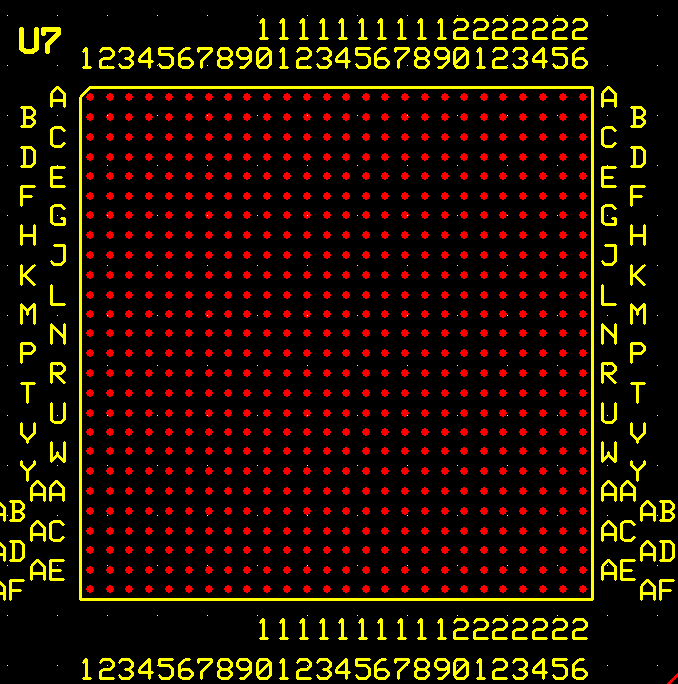

Checking spacing for the 676-pin beast on the 6"x3.5" board. Some trimming and IC reorganization... Looks good so far. I'll work on the VCCINT power pin plane since it requires a separate dedicated power plane within the 3.3v power plane. Also, I'll assign the ground pins.
Interesting observation: More User I/O pins, same number of P/N_GCLK pins as the 256-pin Spartan 6.

Currently, I'm aiming for a XC6SLX45-3FG676C. LX45 is the smallest of the Spartan 6 family with a 676-pin count and 1mm ball spacing. The device is 27x27mm. Currently it is $84 on avnet.express. Much better! This gives me confidence to proceed with this design, although they have none in stock with a 6 week factory lead time with minimum order of 1. No problem! I order one tonight and probably I'll be done in 6 weeks.
Will I use all 676 pins? Absolutely not, but a greater percentage will be able to be routed out from all sides of the wider square on this 26x26 ball FPGA.
Just FYI, a note on Xilinx FPGA blockRAMs: I've been working with the LX9 series of Spartan 6, the 144-pin QFP version, on the 1080p PVB's for the past year. I've just about max'd out the available blockRAM usage @96%. Those boards have 1Kx16 zero page, 1Kx16 stack page, 4Kx16 ROM for the 65Org16, and another 32Kx16 storage for X,Y coordinate storage. So that's about 38Kx16 available blockRAM on that series of LX9.
The LX45 series blockRAM has approximately 152Kx16, 4x that of the LX9 series blockRAM. It's about 4x the price too ($20 to $80 as mentioned).

Re: K1 Controller Board with Video Capture
A fresh start
Alot of (n) - (no connects) on the LX45. Lucky for me this design does not require alot of connections north of pin A1.
I put some yellow paint to help me out... This is going to be difficult routing on a 6"x3.5" board.
