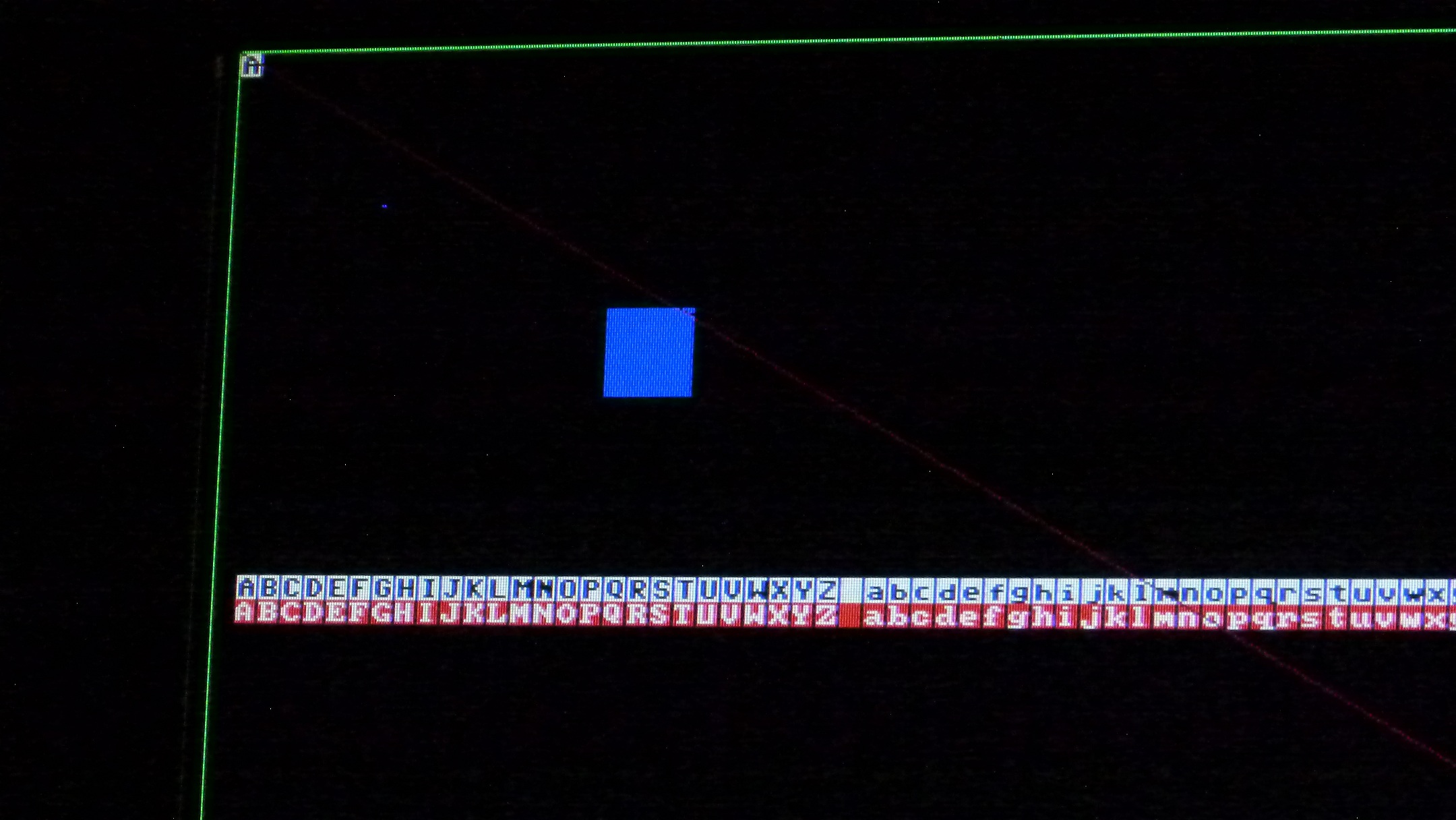

6 functions are tested here. The software is well documented, trying to do myself a favor for future viewing. Pix to follow soon.
;----Draw Green Border. Purpose: Test +-dx vs +-dy Line drawing-----------------
                  LDA #%0000011111100000       ;green pixel for a Border
                  STA color
                  LDA #0                       ;from top left to top right
                  STA lx0
                  STA ly0
                  LDA #1919
                  STA lx1
                  LDA #0
                  STA ly1                      ;Draw Line!
                  STA lx1                      ;from top left to bottom left
                  LDA #1079
                  STA ly1                      ;DRAW Line!
                  STA ly0                      ;from bottom right to bottom left
                  LDA #1919
                  STA lx0
                  LDA #0
                  STA lx1
                  LDA #1079
                  STA ly1                      ;Draw Line!
                  LDA #1919                    ;from bottom right to top right
                  STA lx1
                  LDA #0
                  STA ly1                      ;Draw line!
;----Plot 4 Characters. Purpose: Test Read/Modify/Write on register Att.........
                  LDA #%0000000000000000       ;setup pixel color for character
                  STA color                    ;plotting
                  LDA #%1111111111111111
                  STA bcolor
                  LDA #$21
                  ORA #%0000000100000000        ;set bit for C-64 font
                  STA Att
                  LDA #1
                  STA cX
                  STA cY                        ;!Plot Char 'A'. top left
                  INC Att
                  LDA #1079-8-1
                  STA cY
                  INC Att                       ;!Plot Char 'B'. bottom left
                  LDA #1919-8-1
                  STA cX
                  LDA #0                        ;!Plot Char 'C'. top right
                  STA cY
                  INC Att
                  LDA #1079-8-1
                  STA cY                        ;!Plot Char 'D'. bottom right
;----Plot Character String. Purpose: Show all available Characters & Fonts------
                  LDX #10
                  STX cX
                  LDY #200
                  LDWi $0000                  ;LDW #0

CHARSTRING        .BYTE "ABCDEFGHIJKLMNOPQRSTUVWXYZ abcdefghijklmnopqrstuvwxyz 0123456789 !@#$%^&*()_+-=[]{}\|;',./<>?", $0D
;----Copy/Paste. Purpose: Test hardware copy/paste function---------------------
JOC               LDA #100
                  STA bXlen                  ;length of horizontal copy/paste
                  LDA #10
                  STA bYlen                  ;length of vertical copy/paste
                  LDA #0
                  STA bXc                    ;copy start X coordinate
                  LDA #200
                  STA bYc                    ;copy start Y coordinate
                  LDA #900
                  STA bXp                    ;paste start X coordinate
                  LDA #200
                  STA bYp                    ;BLIT! paste start Y coordinate
;----Read color of pixel. Purpose: Read color of a pixel and use value for Fill-
                  LDA #%000000000011111      ;blue pixel
                  STA color
                  LDA #60
                  STA Xp
                  STA Yp                     ;Plot!
                  LDA #60
                  STA Xr
                  STA Yr                     ;Read!
                  LDA colordata
                  STA color                  ;
                  LDA #32
                  STA fXlen
                  LDA #32
                  STA fYlen
                  LDA #150
                  STA fXs
                  LDA #100
                  STA fYs                   ;Fill rectangle with read color
;----Plot Line. Purpose: Test Line Drawing Max Range----------------------------
                  LDA #%1111100000000000    ;red
                  STA color
                  LDA #0
                  STA lx0
                  STA ly0
                  LDA #1919
                  STA lx1
                  LDA #1079
                  STA ly1               ;draw line from top left to bottom right
geck              JMP geck              ;end
ElEctric_EyE
Posts: 3260
Joined: 02 Mar 2009
Location: OH, USA
Re: 1080p HD Video on custom FPGA/VDAC/2MBx18 SyncRAM board
Post by ElEctric_EyE »
Not so good with the camera! Pixel rate is 150MHz. Monitor expects 148.5MHz for 1920x1080. Could explain apparent ghosting of pixels? I will test..
