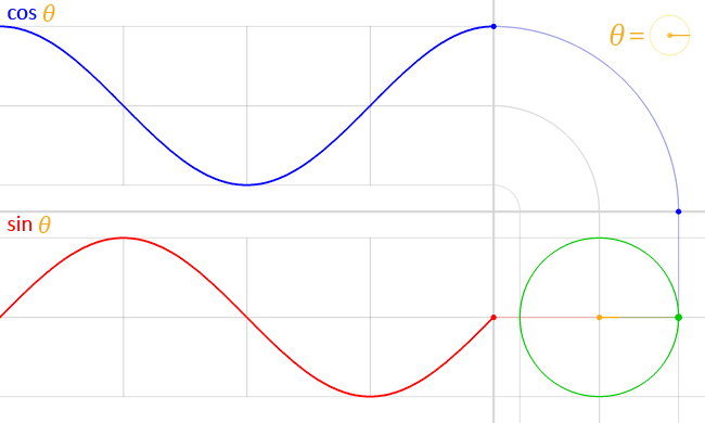

I still haven't made any headway into generating a sine wave with a controllable amplitude from a LUT, so I decided to tackle another portion of the project which needs attention, i.e. how to resolve video ram contention with cpu/hardware accelerator access. Also, on this projects' software side of things, I am attempting to port Bruce's take on Bob Bishop's Mandelbrot program to 65Org16. I will start a new thread on that very soon...
