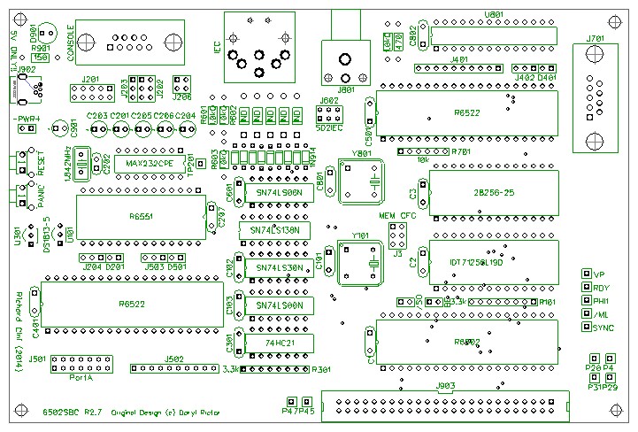

I've made some additional enhancements to the V2.6R3 board (now calling it V2.7R0). Among the additions from the last turn:
    * Added: Programmer's "panic" button via the NMI input; reworked NMI handling (no wired-OR)
    * Commodore/Atari-compatible joystick interface
    * Text video output using Daryl's one-chip video solution
    * Slightly new board layout with connectors arranged differently so that it could be case-mounted
I attached a picture of the board plot below. I plan on doing a small order of boards which I should receive in a few weeks. If those work, I'll offer the extras up to the list.
On the software side, I've added a command for reading the joystick, and I'm making progress on the DOS commands.
Enjoy!
Rich

I received the boards and built one this afternoon and it works. There is one cosmetic issue with the placement of the video connector - it is set about 0.3" too far back from the edge of the board for the connector I selected. there may be other connectors that you could use.
If anyone is interested in a board, I have seven (7) available...they are available for $25 each plus S/H. Please PM me if interested.
The project page is here: http://www.classiccmp.org/cini/6502proj.htm
Rich
Crack open some bubbly!
Is it practical to do a little routing on the board to compensate?

There are traces in the area between the connector and the edge, so you won't be able to route it. There are other RCA connectors with longer necks (on Digi-Key, search for CP-1421) that would minimize the problem for case mounting. Otherwise, I think everything else is good.
