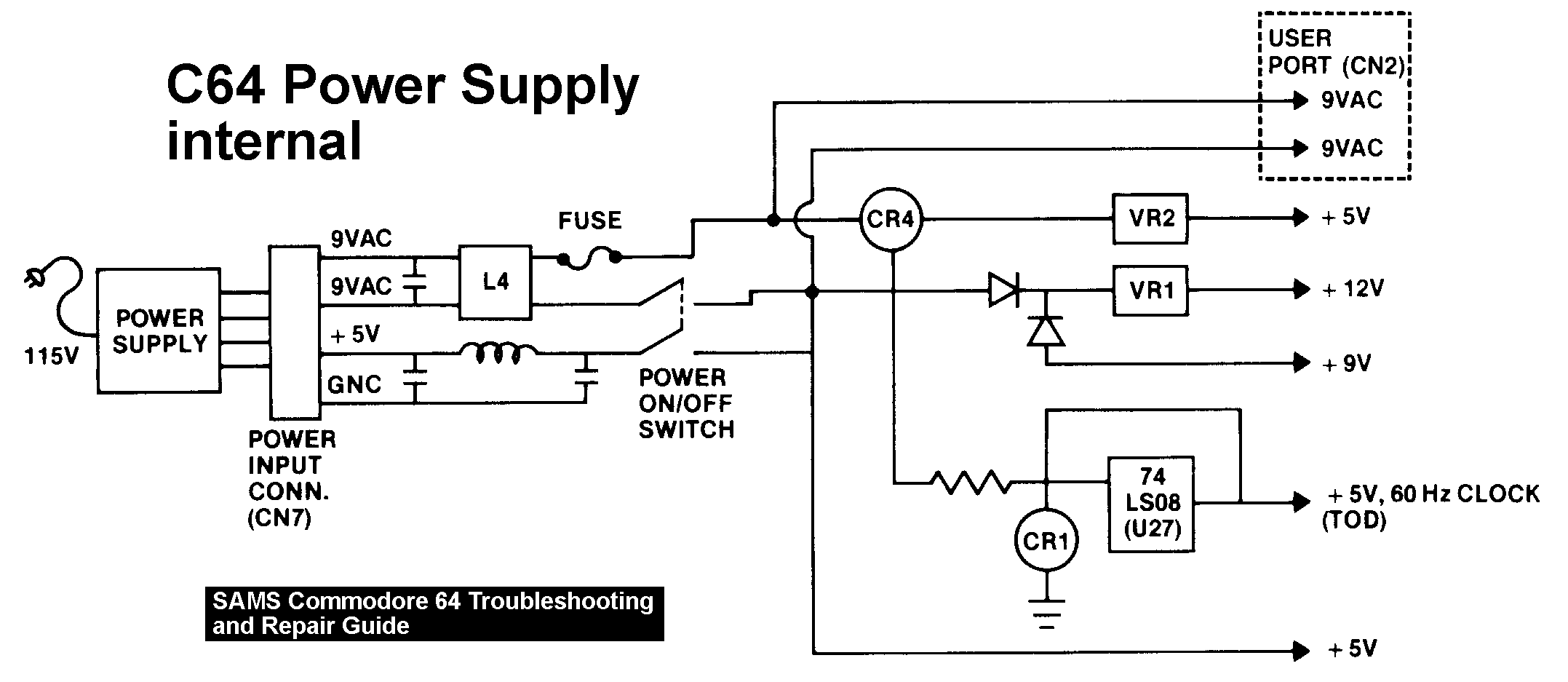

A friend brought me today a C64 and a C128 in unknown conditions with no power supply. There is no reason why they shouldn't work, but when I wanted to power them up I found out that the thing needs 9V along with 5V, so since I didn't have such a supply I stopped poking and left it aside.
Why do this system need a 9V supply anyway?

The 9V~ is used to create various DC voltages and is essential.
The C64 can be used for games, controlling peripherals, program in assembly and much more. The CPU is the 6510, which is very similar to the 6502. It has an additional 6-bit I/O port addressable at $0000 and $0001. The graphics (VIC-II) and sound (SID) are remarkable and ahead of its time. The C64 scene is very much alive.
The C128 is in essence a C64, a C128 (with double RAM and better BASIC) and a Z80 CP/M compatible computer.

I can read a schematic as well as the next guy, but I wouldn't use the one posted from the SAMS manual for anything except scratch paper. Depending on that schematic being an accurate representation of the power regulation circuits will certainly require the C64 to be repaired.
There must be another source for the schematics of the power conversion circuits for C64. Perhaps there's a user group dedicated to it, and one of their members can supply a schematic for these circuits from the original Commodore documentation.

I have a feeling the drawing Marco posted is intended as a block diagram. In that sense perhaps it's adequate, but I agree you'll need to find a better reference if you intend to repair or reproduce the power supply.

Michael, I’d like to see myself as a C64 enthusiast but I see your point. The diagram is more intended for a global overview. I’ll include a schematic from the C64 service manual from march 1992. It shows the internal power supply and what the 9V~ is used for.
The power “brick” itself consists of a transformer with 2 x 9V~. One 9V~ is used to create a stable 5V=, and the other goes directly to the power connector.
The C64 power supply isn’t the most reliable and should be replaced with something better. I for myself use an ATX power supply for the 5V= (with a 2A fuse) and mounted a new 1 x 9V~ 2,7A transformer.

Unless it is your intention to bypass and replace the power regulators in the C64, I think that lordbubsy's recommendation is your best path forward. Applying 9Vdc instead of 9Vac will not correctly power the C64's internal regulators.
There is a concept embedded in the power circuits shown in the last schematics that is worth studying. The 9Vac power signal is rectified by a full-wave rectifier CR4. The output of CR4 is called +9Vdc(unregulated), and it feeds the 7805 linear voltage regulator and another diode, CR6. The cathode of CR6 feeds into the anode of CR5 and to a dc blocking 470 microfarad capacitor. The unregulated +9Vdc signal passing through CR6 biases the capacitor so that on the next positive half cycle of the 9Vac power signal, the additional charge plus the power signal is rectified by CR5. The result is a signal at the input of the 7812 linear voltage regulator that is greater than +12Vdc.
This voltage pumping circuit achieves two goals. First, it keeps the voltage at the input of the +5V 7805 linear regulator to a level that doesn't cause too much power to be dissipated in that linear voltage regulator. Second, it raises the voltage input to the +12V 7812 linear regulator so that it can regulate its output properly while not being subjected to too high an input voltage. Power dissipation across linear regulators should always be a concern, and applying high input voltages is the primary manner that most linear regulators are damaged by users.
I think that the power regulation arrangement you see in the C64 is a good example of an economic design. It is not overly complex, and makes effective use of a single transformer to provide both +12Vdc and +5Vdc without subjecting the +5Vdc linear regulator an input voltage that would lead to excessive power dissipation.
All that said, unless you are willing to completely scrap the circuits in the C64, your best approach to powering your C64 and C128 is to follow lordbubsy's recommendation to supply the 9Vac from a standard wall wort.

Note that the C-64 (and C-128) requires the 9 volt AC input for the aforementioned charge pump circuit, and as an input to the two CIAs. The CIA depends on the power line frequency to run the time of day clock. This is another case of "don't make it complicated." All the C-64 needs is 5 volts DC and 9 volts AC to operate.

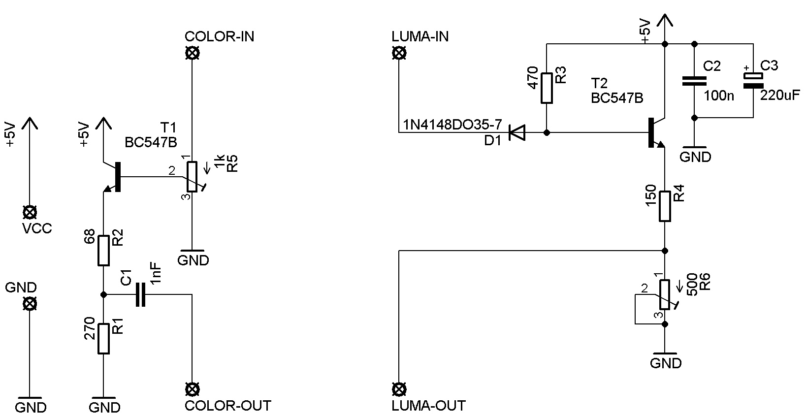

S-Video hack
This is a less common hack to provide a very good S-Video signal, it involves removing the HF-Modulator and provides a new circuit for delivering chroma and luma separately from the VIC-II to the CRT monitor.
