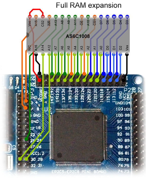

My web page has only recently gone online so there are some updates to do to it (32K RAM expansion, enhanced screen etc, as found on the original upgrades).

The second modification is a really cheap and simple hardware mod to expand the RAM to the maximum that BASIC will recognise - 40K, plus any holes in the memory map higher up (eg between the ACIA, ROMS and display) are filled with RAM so they can be peeked/poked or used for machine code.

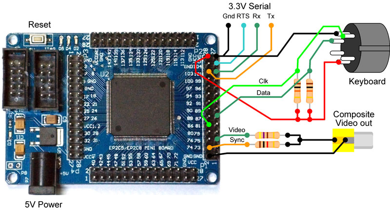

One thing I notice on your schematic is that you are missing the pull-ups (10K approx) on the PS/2 lines (not sure if the weak pullups, if enabled on the FPGA, are strong enough). These are needed because the keyboard is "open collector". They may be floating so working sometimes. Also, I power the keyboard at 3.3V (no issues with any that I tried) so don't use serial resistors.

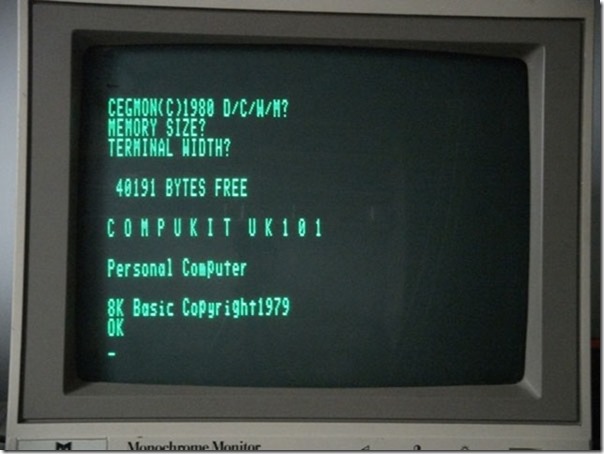

Details to allow the full 64x32 display on-screen plus "turbo" mode by pressing F1 on the keyboard are now fully working and online. The CEGMON ROM code is auto-patched by the VHDL to use the required default parameters for full screen 64x32. In turbo mode, the VHDL patches the auto-repeat delay loop value to ensure typing is still possible!
Standard UK101 speed is 1MHz. Turbo mode can be up to 16.66MHz using the external SRAM that I mention, but is possible to achieve 25MHz with fast SRAM and short wires. Will also work at 25MHz with internal RAM. However, 16.66MHz should be fast enough ;) The actual turbo speed can be set as needed by applying appropriate values to the VHDL code. Full details, as always, on the page.
A pic showing the 64x32 display is below. Games such as space invaders also still work in this mode, but appear smaller (obviously!). Looks nice and clear on a modern LCD TV as well.

Is there a speed difference? The internal weak pull-ups may be much too weak to charge up the capacitance on the line in time for a faster speed. I seem to remember that for the PS/2 keyboard interface normally uses 4.7K, whereas internal weak pull-ups are anywhere from 100K to 20M on various ICs.
