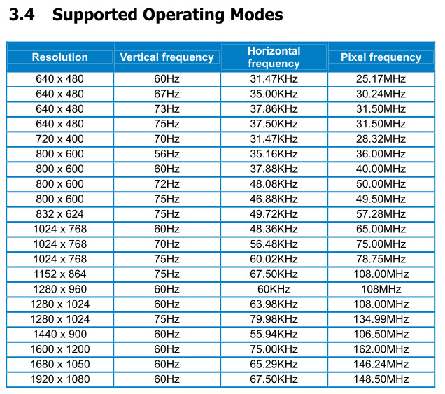

Flat panel displays are a whole different beast I've discovered. Older ones seem to recognize a wider array of HSYNC/VSYNC/pixel freq's. They will display them, but some parts of the pixel display may be fuzzy.
Now, I've been doing research into TFT/LCD flat panel display freq's in their owner's manuals to find out the exact HSYNC/VSYNC/pixel freq's expected.
For 1920x1080, I got it to work on the old viewsonic at a pixel clock of 140MHz, much lower than I expected but some parts were blurry. Not acceptable.
This will not work on my ASUS MT276HE, which is why I am currently doing research into the owner's manuals of other flat panel displays of newer production, in order to see what the expected freq's are for 1920x1080p.
This is from the MT276HE manual, it should be no problem getting a proper display soon:
