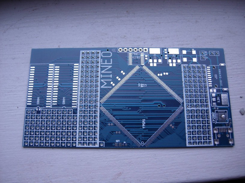

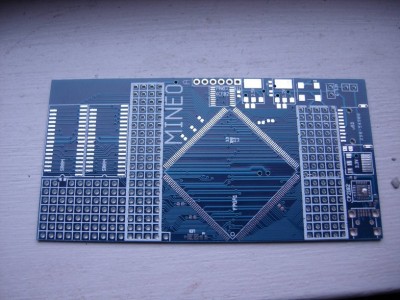

I just received the prototype boards from the fab for the first iteration of MINEO. I had to compromise a little to get the project moving (18 bit RAMS will have to wait for a while). The board wound up with:
    -XC3S400 FPGA
    -XCF02 platform flash
    -JTAG port as usual
    -2 x 128K (or 512K) SRAMS wired as 16-bit-wide memory
    -uSD card connector
    -CP2102 USB-serial converter (I am having issues with the circuit, will probably not populate for now)
    -USB for power (and serial when it works)
    -regulators for 3.3V, 2.5V and 1.2V
    -lots and lots of IO
    -a small prototyping area near RAMS for extra circuitry
I don't have time to check it now... I am sure I made some stupid mistake and will have to run another PCB.
My hope is to use this board as a reference platform for the 65org16 processor family. My price target is $50; I think I can make it work.

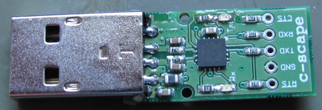

In my USB serial converter I use a FT230x. It also does not require an external oscillator, and has good driver support.

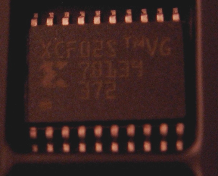

I am beginning to suspect that a batch of XCF02s and XCF01s I bought on AliExpress are fake. They are slightly different from the XCF01s I have that work (they are flat, the good ones have a dimple on top). I now have 4 CHOCHIs that just don't work.
The MINEO board would not scan via JTAG until I replaced the XCF02 with a good XCF01. I put another XCF02, and it's not scanning again...
I will try sticking and XCF01 again and see if I can actually configure the XC3S400. The '01 is not big enough to keep the bitstream, but is required for the JTAG chain to operate.

PostPosted: Mon Nov 18, 2013 8:44 pm
enso wrote:
I am beginning to suspect that a batch of XCF02s and XCF01s I bought on AliExpress are fake. They are slightly different from the XCF01s I have that work (they are flat, the good ones have a dimple on top)...
How do you know where pin 1 is on the ones you suspect are fake, since these do not have dimples?
PostPosted: Tue Nov 19, 2013 12:31 am
Online
Posts: 900
Instead of the slight round indentation, they have a silksreened dot! Bastards.
I am getting more and more convinced that the XCF02s are problematic. I built another board. It does not scan with the 'XCF02'. It works without the XCF02 (at least IMPACT recognizes the XC3S400) after I short a couple of pins to complete the JTAG circuit. It also works with my tried and true XCF01s (Both XCF01 and XC3S400 are recognized).
Aw, heck. That's the last thing I need to deal with.
EDIT: At least I have a MINEO board that may work! I'll have to scramble to make a bitstream to flash the LED...
EDIT: I also got the CP2102 working in a semi-populated MINEO board.

Here is a pic of the fake chip. Note that there is no dimple, just a painted dot. Sorry about the quality of the image...
Here is a picture of what's likely to be a good chip:

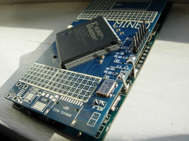

I am flashing an LED with my torture setup for Mineo:
That means that power connections, clocking and at least some IOs are OK.
The bottom board provides USB power and was the initial build. The top board has the FPGA and the crystal. Perhaps it's time to build a full board...
