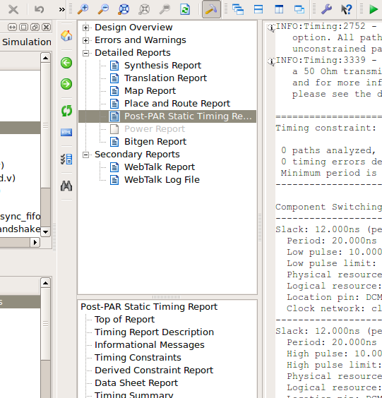

PostPosted: Sun Nov 17, 2013 7:24 pm
In ISE, open Design Summary. It has a section "Detailed Reports", and one of them is the "Post-PAR Static Timing Report"
If you have timing errors, you can open the Tools/Timing Analyzer from the main menu.
Also, you can check the Design Overview Summary for errors.
