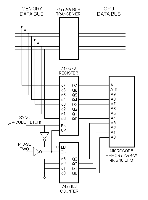

KK microcode addressing (big).gif (9.44 KiB) Viewed 1990 times
scotws wrote:
Just curious, has anybody done anymore work in this direction?
Working separately, the OP and I both designed hardware that captures the opcode present on the data bus when SYNC is high. This (and a cycle counter and ROM) can yield info regarding what the CPU is doing on any given bus cycle.
Jorge wanted that information so he could identify 6502 dead bus cyles, and reallocate them for DMA. (An alternative approach is to use an '816 instead. '816 unused bus cycles are trivially easy to identify; just look for VPA and VDA simultaneously low.)
I wanted that information so I could build a microcoded exoskeleton that expands the 65C02 architecture with new instructions and registers. The misleadingly named "KimKlone" project was successfully completed, and is documented on my web site with a short summary as well as a detailed description. There's a 6502.org thread about the KimKlone here. And yes, a modern-day alternative is to use an '816 instead! :D
The link Jorge used in his lead post is now defunct, but what he showed was similar to the diagram above. Wanna try doing something like this yourself? There's a potential problem regarding interrupts. Surprisingly, perhaps, it's possible for an opcode to be fetched yet not executed. See the comment about the XOR gate in this post.
