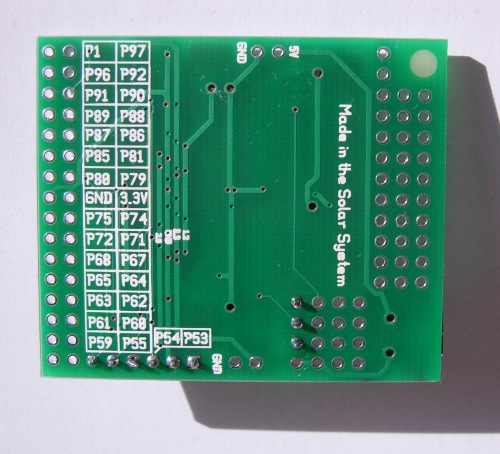

Here is the backside: I try to put a table of pinouts right on the back of my boards. It's much easier than digging through a pile of paper or the filesystem when you need to know how a pin is connected.

Here is a labelled diagram:
A couple of new additions:
-a crystal disconnect solder jumper (drop a ball of solder to disable the on-board crystal)
-2 normally unused pins (for 512K SRAM) are routed to 2 pads for optional serial handshaking
