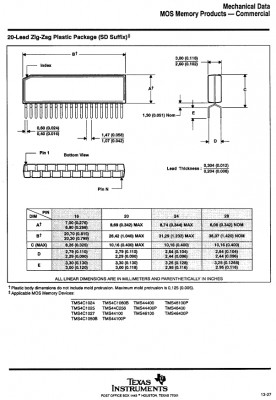

I used to salvage memory SIPPs (not SIMMs) with broken pins back when they were used in MC68000-powered minicomputers. At the time, a single SIPP was many hundreds of dollars (and didn't have all that much memory on it), and due to the way they were designed, it was very easy to break off a pin.
Like this?
PostPosted: Mon Oct 21, 2013 1:28 am
Posts: 8411
Like this?
No. SIPP = Single Inline Pin Package. The device engages a single row of holes in the receptacle. Wikipedia has an illustration.
SIPPs were relatively short-lived due to their fragility and cost to produce. Also, there was some evidence that the package had more parasitic capacitance than an equivalent SIMM or DIMM.
