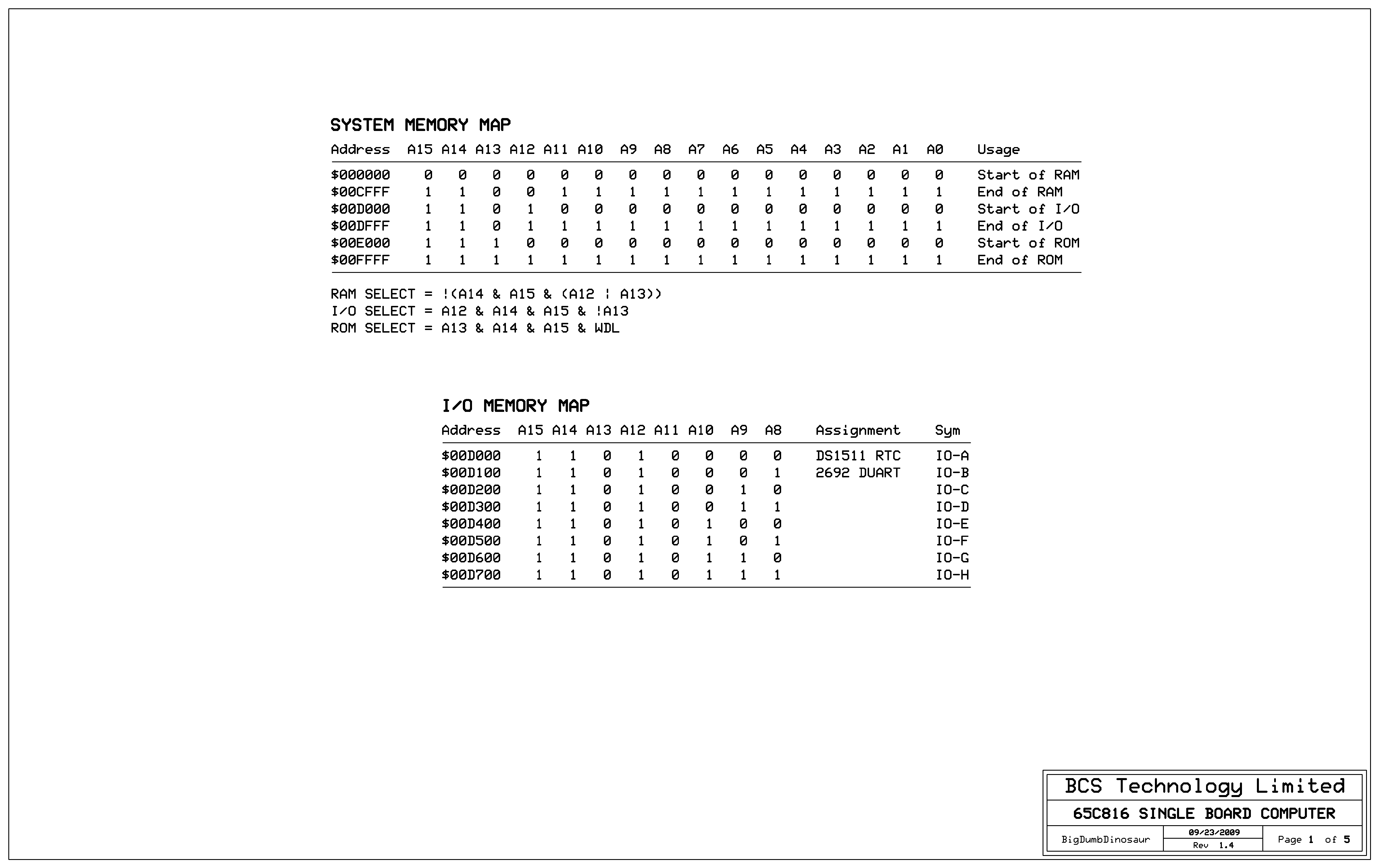

whartung wrote:
Garth laughs when I mention Karnaugh maps, but these were the technique I was taught for trying to simplify logic like this. You create effectively truth tables of what goes in, and what you want out, and then apply some techniques to simplify it, and in the end you get the collection of logic operations (AND, OR, NAND, NOR, EOR) to get the desired outputs for the desired inputs.
Not necessary for simply logic.
Here's the table I developed for POC V1. Truth tables are very useful for this sort of thing. Better to debug your logic on paper than in a DOA device.
File comment: POC V1 Memory Map
